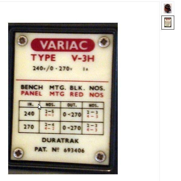

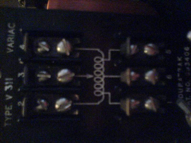

anyone point me in the right way to wire this variac up correctly...i'm wanting to control the speed of a fan running at 240v

Connect incoming power to terminals 2 and 5. Connect the motor to terminals 2 and 3.
