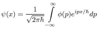

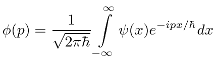

Hi. I never understood why the momentum wave function ##\phi (p)## is the Fourier transform/integral of the real space wave function ##\psi (x)##. Basically, the second pair of formulas here http://quantummechanics.ucsd.edu/ph130a/130_notes/node82.html,
and
(and the rest of the text, for that matter) makes little sense to me. Is there any intuitive reason behind the formulas?

Note that the equality ##\psi(x)=\frac{1}{\sqrt{2\pi}}\int_{-\infty}^{+\infty} \phi(p)e^{-ipx/\hbar}dp## is saying that ##\psi## is a kind of generalized linear combination of momentum eigenfunctions (with all possible eigenvalues).
Indeed. And I think I will give up trying to understand why.

Are you familiar with the Dirac notation? If so, the derivation is not so difficult.
A wave function in the position representation is defined as: ##\psi(x,t)\equiv \left<x|\Psi(t)\right>##
A wave function in the momentum representation is defined as: ##\phi(p,t)\equiv \left<p|\Psi(t)\right>##
I can insert a resolution of the identity:
$$1=\int_{-\infty}^\infty dx\left|x\right>\left<x\right|$$
Into the second equation to get:
$$\phi(p,t)= \left<p\right|\int_{-\infty}^{\infty} dx \left|x\right>\left<x|\Psi(t)\right>$$
Therefore:
$$\phi(p,t)= \int_{-\infty}^{\infty} dx\left<p|x\right>\psi(x,t)$$
All we have to know then is ##\left<p|x\right>##.
To find this we look back at how these vectors are defined. These vectors are defined as the eigenvectors of the momentum and position operators respectively:
$$\hat{p}\left|p'\right>=p'\left|p'\right>$$
$$\hat{x}\left|x'\right>=x'\left|x'\right>$$
In particular then, we have:
$$-i\hbar\partial_x\left<x|p\right>=\left<x|\hat{p}|p\right>=p\left<x|p \right>$$
This equation has solution (check it by taking the derivative):
$$\left<x|p\right>=Ce^{ipx/\hbar}$$
The constant of normalization ##C## can be found by the requirement:
$$\left<p'|p\right>=\delta(p'-p)$$
Again adding in a resolution of the identity we get:
$$\left<p'\right|\int_{-\infty}^{\infty} dx\left|x\right>\left<x|p\right>=|C|^2\int_{-\infty}^{\infty} e^{i(p-p')x/\hbar}dx$$
We know this integral from Fourier analysis (essentially, from Fourier's inversion theorem we know this must be true):
$$ |C|^2\int_{-\infty}^{\infty} e^{i(p-p')x/\hbar}dx=2\pi\hbar|C|^2\delta(p-p')$$
Matching this condition with the normalization requirement gives:
$$C=\frac{1}{\sqrt{2\pi\hbar}}$$
Therefore, we finally have our final formula:
$$\phi(p,t)= \frac{1}{\sqrt{2\pi\hbar}}\int_{-\infty}^{\infty} e^{-ipx/\hbar}\psi(x,t)dx$$

It's essentially just that an integral can be approximated by a sum. For each p, define ##u_p:\mathbb R\to\mathbb C## by ##u_p(x)=e^{ipx}## for all ##x\in\mathbb R##. (I'm using units such that ##\hbar=1##). A linear combination of several of the ##u_p## functions would look like this: ##\sum_k a_k u_{p_k}##.
$$\psi(x) =\frac{1}{\sqrt{2\pi}}\int \phi(p)e^{ipx}\mathrm dp =\frac{1}{\sqrt{2\pi}}\int\phi(p)u_{p}(x)\mathrm dp \approx \frac{1}{\sqrt{2\pi}}\sum_k \phi(p_k) u_{p_k}(x)\Delta p_k =\left(\sum_k \frac{\phi(p_k)\Delta p_k}{\sqrt{2\pi}}u_{p_k}\right)(x).$$
I'm well aware that an integral is an infinite sum, and I understand that the wave function ##\psi(x)## is a linear combination of momentum-eigenfunctions multiplied by ##\phi(p)## (the wave function in momentum space). What I don't understand is why the latter is true. But as matterwave has been so kind as to post a proof, I'll go learn bra-ket notation and return to that :smile:On another note, I think I understand dirac-delta normalization now. I read a bit on the function, and found that the integral of a complex exponential function is the sinc function, which will converge to become the delta function if the integral of the complex exponential is taken from minus infinity to plus infinity.
Hence this trick can be used to normalize momentum eigenfunctions,,, even though it makes no sense from a physical standpoint. And all this stuff seems to go against the interpretation of QM where ##|\psi \psi^*|## equals the probability density. They made an exception for non-normalizable eigenfunctions like the momentum eigenfunction?
