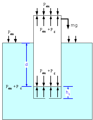

A hollow cylinder with closed ends is 300 mm in diameter, 450 mm high, has a mass
of 27 kg and has a small hole in the bottom. With its axial vertical, it is lowered
slowly into water, and then released. Calculate
a. The gauge pressure of the air inside it
b. The height to which the water will rise within it
c. The depth to which it will sink
Disregard the effect of the thickness of the cylinder wall but assume that it is uniform
and that the compression of the air inside is isothermal.
I already created an equation to find the pressure of the air inside the cylinder.
P = Patm +γ(h-h')
where h is the height of the column of the pressurized air in the cylinder and h' is the height of the cylinder that is protruding out of the water.
Using this I continued to make an equation for the forces on the cylinder. I figured the forces on the cylinder would be an upward buoyant force from the water, a downward weight, and a downward pressure force acting on the surface area of the cylinder. So my equilibrium equation would be...
Fb = W + PA where P is the air pressure that we said above so,
Aγ(H-h') = mg + [Patm + γ(h-h')]A once everything is simplified, we get...
h = H - [mg + APatm]/Aγ
Apparently this doesn't work because I get a negative value for h, and the height of the air column in the cylinder cannot be negative. My professor provided the calculated answers to these questions but the solutions are provided. someone please give me some insight

Yes there is a buoyant force, but because of the geometry of the cylinder it can be resolved as a pressure acting upon the enclosed water/air interface, and transmitted to the underside of the cylinder top via air pressure. In effect, the cylinder is sitting on and supported by a column of air.
Note that for calculating the required gauge pressure inside the cylinder that the atmospheric pressure is a baseline (it's a background pressure affecting everything equally) and can be ignored -- it's the "overpressure" Pg that supports the weight of the cylinder. You will have to include it, though, when working with PV = nRT. You should be able to determine the required gauge pressure without requiring any reference to the cylinder's depth of submersion.

Ok I think I understand where you are going with the diagram and it is a big help. I just need some clarification in it since you are using different variables than me.
1. Why is there not an actual buoyant force like there always is? For instance, how come there isn't an Fb = γVsubmerged like usual?
2. Is Patm + Pd = Patm + γd? and why is it acting upwards? Is it the reaction force from the air pressure from the column of air pushing down?
3. Is Patm + Pg the absolute pressure inside the column of air?
I was able to work this out and get the right answers. But I am still a little confused as to how you got all those forces...
The buoyant force is the result of pressure which operates perpendicular to the submerged surfaces of the object. Pressure on vertical surfaces all cancel out (otherwise the object would move horizontally through the water!), leaving only the horizontal surfaces with unbalanced force. For a solid object the buoyant force is the sum of all the pressures operating vertically, which for a solid cylinder would be the pressure on its bottom face.
In this case the cylinder is hollow, so its "bottom" is the air/liquid boundary. Only the pressure of the liquid operating there provides the "lifting" force. There are no horizontal surfaces on the cylinder walls, and the bottom of the cylinder with a hole in it contains liquid with the same pressure inside as outside -- so no net forces there.
Pd is the pressure due to the water at depth d. The absolute pressure at that depth is due to the weight of the water above and the atmosphere above. Pressure in a gas or liquid operates in all directions, but in this case we're looking at the pressure applied to the air/liquid interface.
Yes.
