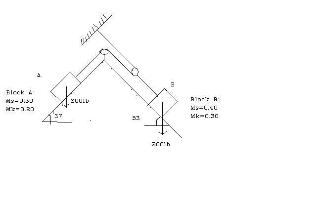

A problem in engineering mechanics:
The blocks shown in the figure are connected by flexible inextensible cords passing over frictionless pulley. At Block A the coefficients of friction are Ms = 0.30 and Mk = 0.20 while at Block B they are Ms = 0.40 and Mk = 0.30. Compute the magnitude and direction of the friction force acting on each block.
the answer is Friction at A = 48lb
Friction at B = 36lb
R is along the angle of friction w/c has two components:
Normal force at the vertical
Friction at the horizontal
I do not know how to approach the problem since there are two given coefficient of friction and it seems very confusing...

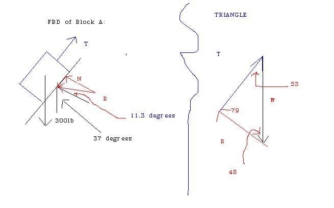

however i tried solving at block A using the coefficient of kinetic friction at A = 0.20:
F = friction
R = the force along the angle of friction
the angle of friction here lies along with R which is the coefficient of friction
tan(theta) = 0.20
theta = 11.3 degrees
so i used sine law:
[tex]\frac{\sin{79}}{300} = \frac{\sin{53}}{R}[/tex]
R = 244lb
R has two components: the normal force N and the friction F
F = (244lb)(sin(11.3))
F = 48lb <<< at A
i am not so sure about this..
can u give some hints its very confusing
I don't quite understand what you're doing. Where did the angle of 11.3 come from?
The first thing I'd do is figure out if this thing moves or not. Does it?
no?
so ill try to use static friction
