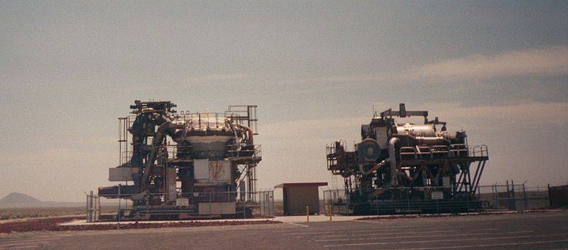

Perhaps you may be interested in nuclear propelled airplanes? The US designed such a system, and found it viable.
http://www.ornl.gov/info/ornlreview/rev25-34/net425.html [Broken]
There are photos of the test engines on wikipedia (they are located at Idaho National Lab):
http://en.wikipedia.org/wiki/Aircraft_Reactor_Experiment
