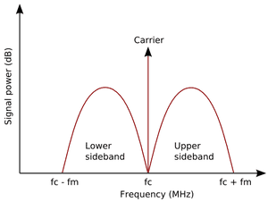

Please forgive me, I never heard of sidebands until now. Refeering to this image
and supposing I have 3 delta functions as you said, instead of the 2 concave functions of the image, I can understand that for the effect of modulation, power is transmitted at different frequencies. I do not understand how to use this concept to get a comparison of group velocity and phase velocity. I'm in search for a book treating these concepts anyway.
You used the term modulation envelope, which is the same as the sideband envelope.
