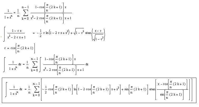

How would I solve [tex] y'(x) = \frac{1}{x^N+1} [/tex] ?

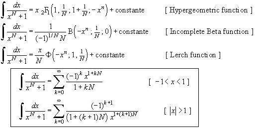

JJacquelin said:Hello !
in order to find a primitive of 1/((x^N)+1), let t=x^N and z = y/x
where z(x) is the new function to find.
This leads to z as an Euler's hypergeometric integral with variable t.
Finally, back to y and x, we obtain the solution :
y = x*F(a,b;c;X) + constant
where F is the Gauss hypergeometric function (usually noted 2F1 in the hypergeometric functions classification)
a = 1
b = 1/N
c =1+(1/N)
X = -x^N
Using the general series definition of the hypergeometric function, it is easy to express y(x) in terms of a rather simple infinite series.
a = 1
b = 1/N
c =1+(1/N)
X = -x^N
