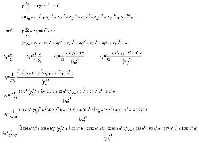

I agree with jackmell's comments :
Ok, it looks like the equation in t is just as difficult and you asked for an analytic solution. You could solve it via power series to achieve that goal although I think it's difficult to determine the radius of convergence of a Cauchy product that would enter into the power series solutions due to the yy' term.
The series development leads to complicated formulas for the coefficients as functions of a, b and c (Attachment below).
It is doubtfull that a closed form can be derived in the general case. May be possible in particular cases, for particular values of a, b, c, or in case of particular relationship between these parameters. This would require specific studies if more information is available concerning the parametrers values or relationship beteween them.

but dear jjacquelin,
actually I don't know about power series method well to solve the equation like you again, since I think you've made a mistake just in transformed form (yy' in lieu of 2yy') in your attachment, so I want to know this mistake makes what difference in your solution that I assumed is true?

Hello,
You are right, but it is just a typing mistake. I forgot the "2" in typing the equation, but I didn't forget the "2" in the calculs. So the series development is correct.
