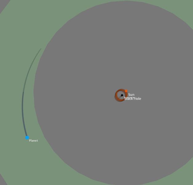

I've worked out a working simulation. It's not really a binary system. I need the star to orbit a sufficiently dense object.
This particular object is 18 suns in mass but only 500000kms in diameter. It has a density of 500g/cm^3
Is this object a black hole?
If not, could there be an object like this but dark?
So the star orbits this black hole in 8 hours which is great for what I need. The planet would orbit the black hole as well but would still fit snuggly in the star's habitable zone. (see attachment. Green is habitable.)
If someone where to stand on the planet's equator and terminator, the star would go up and down at the horizon level just like I wished.
Are there any problems that I missed?

Thinking about it, the central object definitely needs to be a black hole. I've made it about 15 suns in mass, but only 30 kms in diameter.
In order for the star to orbit this black hole in about ten hours, It would need to be pretty close to it.
I'm guessing a star orbiting that close would get sucked into the black hole. Forming an accretion disk and two crazy jets.
A star wouldn't survive that close, right?

The BH would be 90 km in diameter.
At ten hours, the star would be within the Roche limit for the the BH and be torn apart.
Thanks, I thought as much. I looked into calculating the roche limit, but that sort of math is really beyond me.
So, how far away am I from getting a stable system here? Keeping that short orbit period is the only thing that I really need, I can change everything else.
What direction should I be going? Making the black hole less massive?

Forget what I said, I had forgot that your star was a Red dwarf, (I was assuming a star like our own), and that changes everything.
Fiddling with the size of the BH, won't change anything, because interestingly enough, the orbital period of a body at Roche limit distance is independent of the primary body's mass. What it does depend on is the density of the orbiting object. The denser the object, the shorter orbital period it can have while remaining outside the Roche limit. And a Red Dwarf would be considerably denser than our Sun.
You should have no problem getting a 10 hr orbit around that BH.
As far as coronal mass ejections go, some of more powerful ones would still be able to reach the planet, but they will have lost a good amount of their punch climbing out of the Black hole's gravity well.
