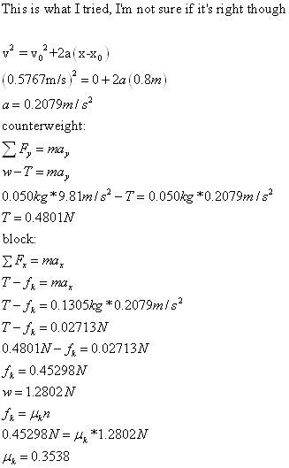

A wooden block with mass 0.1305kg is sitting on a horizontal dynamics track. The block is attached to a counterweight of mass 0.050kg by means of a frictionless pulley (the counterweight is hanging off of the table). The system is released from rest, and after traveling 0.8 meters, the velocity of the block is 0.5767 m/s. Calculate the coefficient of kinetic friction
Can someone please help??
Thanks in advance :)
It seems right.
I would approach this problem by first identifying the known variables and equations that can be used to solve for the coefficient of kinetic friction. In this case, we know the masses of the block and counterweight, the distance traveled, and the final velocity of the block. We can also use the equation for Newton's second law, F=ma, to relate the forces acting on the block.
Next, I would draw a free body diagram to visualize the forces acting on the block. In this case, we have the weight of the block, the normal force from the track, and the force of friction acting in the opposite direction of motion. The weight of the counterweight is balanced by the tension in the string, which can be assumed to be equal to the weight of the counterweight.
Using the equations for Newton's second law and the definition of kinetic friction, we can set up the following equation:
ma = μkN
Where m is the mass of the block, a is the acceleration of the block, μk is the coefficient of kinetic friction, and N is the normal force. We can solve for μk by plugging in the known values and solving for μk.
μk = ma/N = ma/(mg)
Where g is the acceleration due to gravity. Plugging in the values, we get:
μk = (0.1305 kg)(0.5767 m/s^2)/(0.1305 kg)(9.8 m/s^2)
μk = 0.5767/9.8 = 0.0589
Therefore, the coefficient of kinetic friction for this system is 0.0589. This means that for every 1 N of force applied to the block, there is a frictional force of 0.0589 N acting in the opposite direction.
I hope this helps! If you have any further questions, please let me know.
