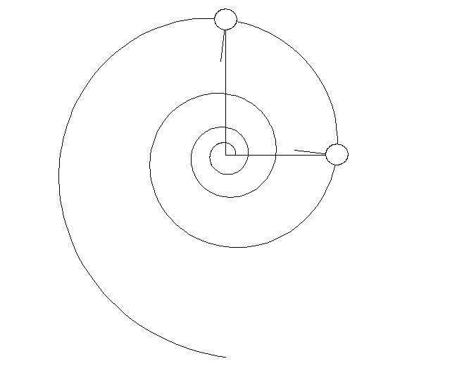

I don't think so. Let m = 1kg be the mas of the upper body, M=2kg the mas of the low body, R = 0.4m the initial radius and v0 = √0.8 the initial velocity (tangential) of the upper body (I got this numbers from an exercise).
We have conservation of angular momentum in the axis that passes trough the hole and is perpendicular to the table.
So v0.R = vt.r (vt is the tangential velocity and r is radius at that moment)
Let vy be the "centripetal" velocity of the upper body (velocity that point to the hole =-dr/dt). vy is equal to the velocity of the low body
Let ay be -d2r/dt2. ay is the acceleration of the low body
If a = F1/m, we have ay = ( a-vt2/r)/2 (I) (look at the picture below)
Conservation of energy:
MgR + mv02/2 = Mgr + m.vt2/2 + (M+m).vy2/2
Substituting vt = v0.R/r, substituting values, deriving in relation to time and dividing by vy we get
ay = 2/3 (10-(0.4/r)3)
So in the initial moment ay = 6m/s²
Now let's suppose by absurd that the forces were equal F1=F2 = F
In the initial moment:
Mg-F = M.ay
But by I we get ay = F/2-1
So 20-F = F-2 -> F = 11N
So ay = 4.5m/s², absurd.
So F1 != F2

Note that if the velocity of the upper mass is not vcp, then it's path is not circular, and the centripetal force, being perpendicular to the path of the upper mass, does not point directly to the hole in the table.
I don't know how to reuse an attachment, so here is an image link to an attachment I have from a previous post. The short inward lines are perpendicular to the path of the mass, and would correspond to the direction of the centripetal component of acceleration of the mass.
I'm sure the path is not circular, and the centripetal force as well does not point to the hole too. There is another solution of this problem where its solved by curvature radius. Actually Fcp = m.v²/ρ, where ρ is the curvature radius.
But note that my solution is NOT that, as well as the ay I've mentioned is NOT centripetal, it's RADIAL (look at the demonstration)
The radial acceleration is resultant acceleration, since the resultant force is radial, so ay is the resultant acceleration on the upper mass.
But the centripetal acceleration is not the resultant acceleration, since we have a tangential acceleration too that summed to the previous one, has the radius direction.

I'm can't follow the details of your derivation in your second post. But I don't believe your result for ##-\ddot{r}## is correct. You found ##-\ddot{r}= (1/2)(a - v_t^2/r)##, where I believe you are using ##a## to represent ##F/m##. There shouldn't be an overall factor of 1/2. You should have found ##-\ddot{r}= a - v_t^2/r##. Note that if ##v_t = 0## then you should get ##-\ddot{r}= a##.
It appears to me that in your diagram and also in the next to last line of your derivation you used the symbol ##a## where you should have used ##a_y## (or ##-\ddot{r}##). But I don't follow your derivation, so I'm not sure. It is not hard to derive the correct expression for ##-\ddot{r}## using polar coordinates. See here for a derivation. The result is that the total radial component of acceleration is
##a_r = \ddot{r}-r\dot{\theta}^2 = \ddot{r}-v_t^2/r##. So, ##-\ddot{r} = -a_r -v_t^2/r##.
In your problem, ##a_r## is what I believe you are calling ##-a##; that is, ##a_r = -F/m = -a##.
Anyway, if you use the correct expression ##-\ddot{r} = -a_r -v_t^2/r= F/m -v_t^2/r##, I think you will find that the tension is the same for both masses.

I've seen my mistake now, it's in the derivation process, you were right TSny. Thanks to everybody that helped me.
