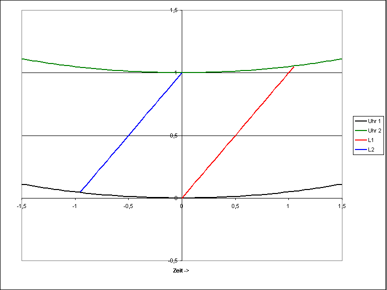

Recently, I made a plot that shows gravitational time dilation in the equvalent case of two accelerated clocks. One can see immediately that the time between two light pulses is longer for the "upper" clock, according to the approximation (1+gh/c²). I don't deal with subtleties like different proper accelerations there, but this derivation of gravitational time dilation should be ok nevertheless.
