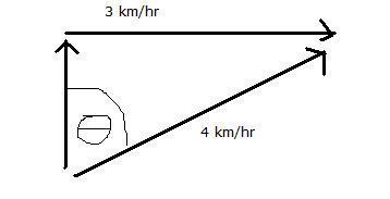

2. My vector diagram contains a vertical vector going north, which would be the straight line path. Above that is the vector pointing to the east, which is the current that flows 3 km/hr, and then the hypotenuse of this triangle is the 4 k/mhr vector of the swimmer. To calculate the angle between the vertical component and the hypotenuse, I used arc sin (3/4) to get a value of 48.5 degrees, which is the correct value, however, in my drawing, I think it ought to be east of north. You can see it in attachment #2.

2) Exactly the same thing as your other thread. Pay attention to the directions in your vector diagram! You have to swim against the flow to counter it!
