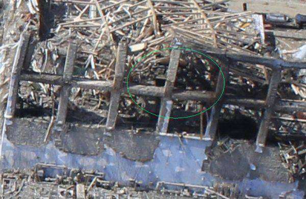

I'm now 95% confident that this is what we are seeing (mind the color is green on the japanese plant and not yellow)
[PLAIN]http://k.min.us/ik0PBa.jpg
as far as the missing top part of the crane I would say that I have a 40% confidence it is there see attachement

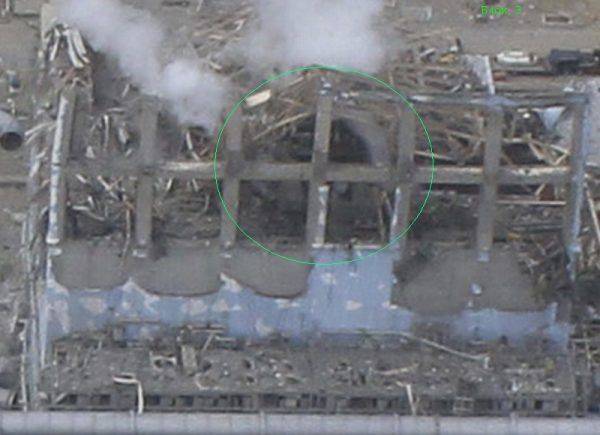

  • #2,305
I agree that the crane is there in #3.
Analyzing this image - I wonder if it has fallen of the tracks, and is laying flat across the center of the building (and the CV concrete lid)

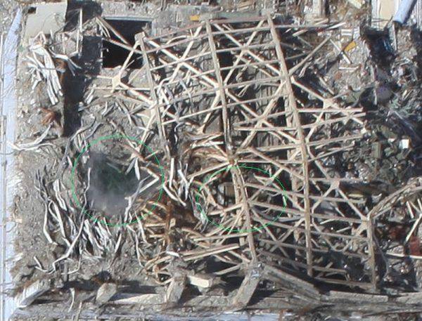

I agree and I think you can be more than 40% confident about that.
A few points:
1) There is clearly water (& debris) in the SFP, indicating no major breach or leak.
2) The reactor mouth is completely covered by debris - mostly the overhead crane, which now rests on the operating floor.
3) The roof framework that survived the blast seems to have been shielded by the overhead crane - obviously a robust structure capable of lifting about 100 tons.
4) Some speculation. The tangled green mess on the north side (see photo) may be the remains of the fuel handling machine. An odd position, but it was an odd day as they clearly were loading spent fuel casks. This would involve the overhead crane and at some point may require moving the fuel handling machine completely out of the way.
Here is a fascinating video of this procedure with several other fascinating videos in the "suggestions":
http://www.youtube.com/watch?v=rh6FeQWuhCs"
