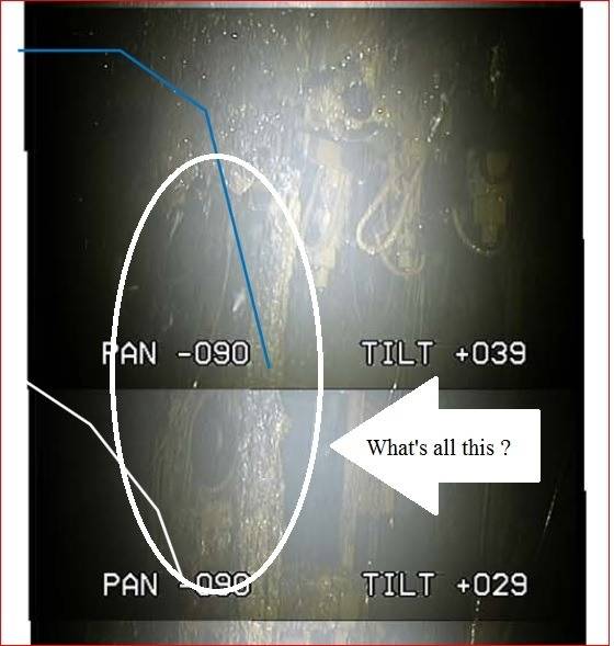

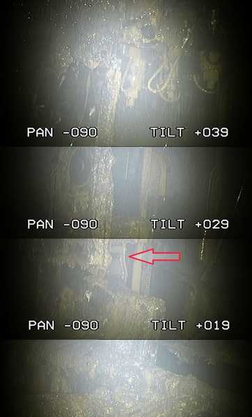

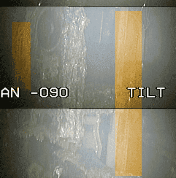

Continuation of the investigation in the PCV of Unit 3
Page 1: This is a quick report on the activities carried out on Oct 22.
They were aiming to take water samples and to evaluate the corrosion inside of the PCV (based on pH, conductivity, salt content). Also to check the access routes (vicinity of X-6 penetration; 1st floor grating; CRD rails) for the investigation of the pedestal area.
Page 2: Using the pan-tilt camera of the water sampling device they checked some immersed structures from the inside of the PCV (electric cables, supporting structures, X-6 penetration, CRD rails) and, as far as they could see, no damage was observed. Some "sediments" ("Deposits") were confirmed on the CRD rails and on the 1st floor grating (see photo 3).
Page 3: Conclusions
- Two samples of water (800 ml each) were taken, one from right near the surface (about 10 cm below surface) and one from a little deeper (about 70 cm under the surface).
- No damage on structures
- Deposits on the CRD-rails and grating
- No obstacles that might cause trouble on the installation of measurement instruments in the PCV.
Page 4: Schedule
Mock-up work will be done throughout November
In late December some measuring instruments are scheduled to be installed in the PVC.

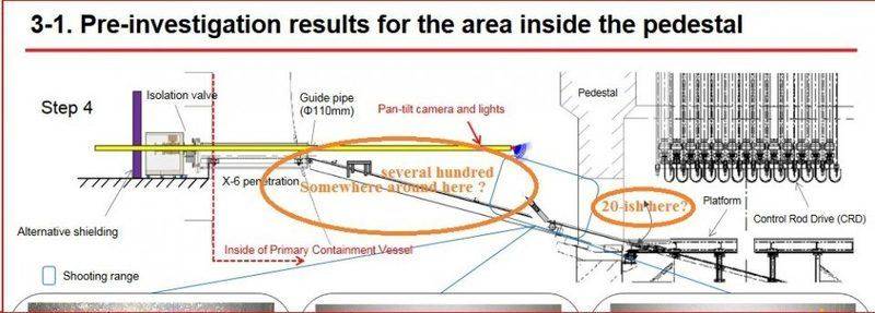

Page 17 and after: Investigation of the contamination in the X-6 penetration area (Unit 2)
You might remember that after they removed those concrete blocks that shielded the X-6 penetration lid they found traces of something that had leaked from the lid onto the floor.
Page 18: the robot used for investigation
Page 19: the radiation values increase downward, from the ceiling of the small room to the floor where the molten and re-solidified deposit is located. It is believe that the radiation dose coming from inside the X-6 penetration is about 1 mSv/h. The robot, equipped with a spatula, was able to scratch away easily some of the deposit.
Page 22: more radiation dose results, this time gamma and beta rays;
