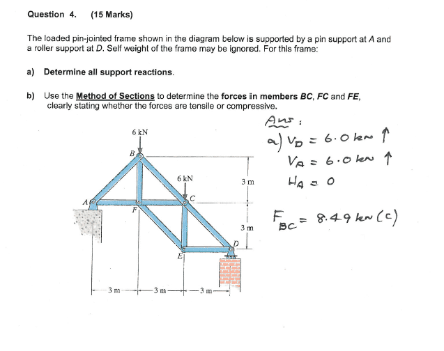

IHi guys with part b of this question im having trouble. I have cut it it at the specified members and used the top half. Now i take the moment at A to get the force in BC. (CW+)M@A=(6*3)+(6cos(30)*3)=0, But when you solve this it dosnt give you the answer its supposed to be, Im probably blind & missing something. Please check out the attachments i provided some more info on it.
Thankyou in Advance.

Where do you get 30 degrees from? Check your triangles.
