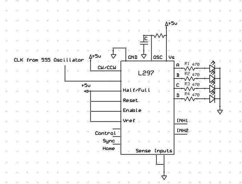

I'm making a circuit around the stepper motor controller L297 on a breadboard, and I've got it working so far. I haven't connected it to the H-bridge and so obviously not to the motor either. But I'm checking the logic levels using 4 LEDs connected to the outputs and they corrospond with the L297's data-sheet.
Here's the really quirky bit, I'm running the circuit using a 9V battery wired to a 5V Regulato which feeds the L297. This circuit is only working off this particular battery. I've got another, fresh, battery that does nothing. The IC remains in its initial stage and no matter how many pulses are applied, refuses to change its state.
I've also wired a cheap wall-wart and I get the same problem.
I've just spent hours and hours on this thing and I'm pretty frustrated because it just doesn't make any sense.
I know its impossible for anyone here to analyze the circuit, but any tips/advice on how to solve the power problem would be MUCH appreciated!

How are you applying pulses to the chip?
Here's a badly drawn schematic of how I've wired the L297:

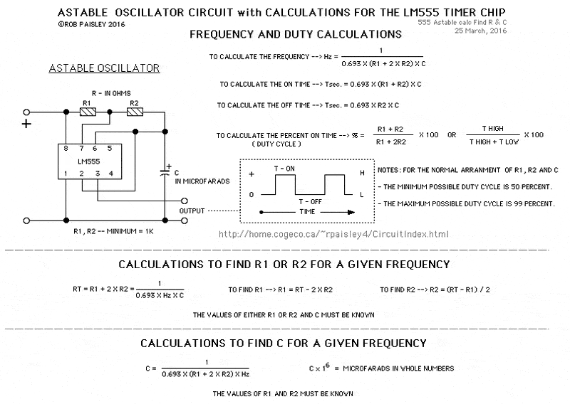

The 555 is wired like this:
From http://home.cogeco.ca/~rpaisley4/LM555.html#2
I looked back at the measurements you did earlier.
The time it worked was when the regulator stopped working and you got less than 5 volts on the chip.
Normal 555s (ie not the CMOS ones) give less than 5 volts p-p square wave output with a 5 volt supply. Sometimes, I have seen it as low as 3.5 volts.
This is a bit of a guess, but maybe the output is not enough to drive the L297 if it is getting the full 5 volts, but enough to drive it if it is getting less voltage.
You could try putting a Silicon diode in series with the L297 after the regulator, but not in series with the 555 so the 555 gets more voltage than the L297.
Alternatively, a CMOS 555 will give the proper 5 volts out if it is getting 5 volts supply itself.
Or, you could run the 555 off 6 volts.

Powered the 555 chip directly off the battery. Had no effect on the operation of the circuit. It works on the one battery and not on the other one. The freq. and duty cycle of the clock is the same on both batteries.
The capacitor and resistor values on my circuit are different than the ones on the data-sheet. Do those matter? They just define the chopper rate. The datasheet specifies the resistor should be higher than 10K (if i remember correctly). Mine is 14K or so.
It is possible that the chip is damaged? Its probably unlikely since it does work under certain conditions.
Also, should I connect the floating pins somewhere? The datasheet doesn't specify if I don't intend to use the chopper feature.
Maybe get some more data.
Floating pins are deadly but in case they are outputs, you shouldn't just ground them. Put 10 K resistors or similar from each unknown floating pin to ground.
If you have a silicon diode, try putting it between the regulator and the L297 chip's pin 12.
It seemed to work better when the supply was low. This will drop 0.6 volts and give you a 4.4 volt supply, purely as a test.
However, maybe it is time to assume the chip is OK and wire it up to drive a motor. At least you will have proper circuits for doing this.
The chip is probably OK if it works sometimes, so it is probably just the test setup that is wrong.
It sounds to me like the chip is pulling spikes of current periodically, which drops the supply voltage and scrambles the chip. the reason i suspect this is that a cold 9V battery and a wall wart don't work, but anohter 9V does work--that sure sounds like there are current spikes that some supplies can handle and others can't (and after the one 9V gets hotter it can handle it because a hotter battery has a bit lower internal resistance). Solution: put both an electrolytic cap and a .01uF cap between 9V (before the regulator) and ground. Watch the polarity on the electrolytic of course( I know you probably know this but thought I'd say it just in case). That should handle the current spikes, if there are any.
Wow, fleem, it worked! I added two capacitors and its working on all batteries (I tried 4) and the wall-wart.
