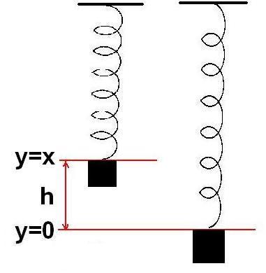

I'm not sure if I got what you meant. Maybe it's like this (see the picture). The left image is when the spring is unstretched, and the right one is when it is stretched 18.3cm. If I choose EP=0 at y=0, then at y=x, EP(x) = mgh = mgx. At y=0, total energy = Ee = 0.5kx2, and at y=x, total energy = EP + EK = mgx + 0.5mv2. Is this what you mean?

I think the issue here is what she means by "equilibrium position." When I think of a mass and spring system hanging from the ceiling, I consider the equilibrium to be the point where the net force is zero. However, she is considering the equilibrium point to be the location where the total energy in the spring is zero.
Using hikaru1221 diagram
it must be noted that at y=x, there is net force on the box is not zero. In this case, the equation she gave is correct.
I guess the OP is stuck with choosing the origin of gravitational energy. Anyway I agree with 6Stang7; the term "equilibrium position" should be made clearer whether it is the equilibrium position of the system or that of the spring only.
Just one more thing to clarify what 6Stang7 said about solving (1/2)mv^2=(1/2)kx^2 for k. Here (in that equation ONLY) x is not 18.3cm; x is the displacement of the spring counting from the equilibrium position of the SYSTEM.
I deleted that section because I was worried that would confuse him, but yes, you are absolutely correct.

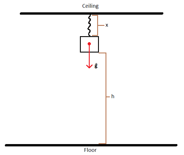

Ok, I made a diagram to bring some clarity to the confusing mumbo jumbo I have written :P
Like I stated earlier my confusion lies within the fact that you can use x as the height in the equation Ep. Why is this viable? I thought you needed the height of the object ABOVE the ground.
So why is it okay to use x, and still get an answer that makes sense? Just need clarification on the theory.
I hope this clears up what I am asking now -- if not I'll get my girlfriend to translate what I am asking into something comprehensible. Sorry I'm just one of those people who needs to know why, I can't help it. :-|

Ah I see the problem now. It's completely wrong. But replacing x by h doesn't make it any better. Now assume that the equilibrium position referred in the problem is the position where the spring is at its natural length. I'll use your latest picture. Here is why:
_ At first, when the spring is stretched 18.3cm, there is elastic energy [tex]0.5k\Delta x^2[/tex] and gravitational energy [tex]mgh_1[/tex] if you choose Ep=0 at h=0. Note that [tex]\Delta x = x - (natural-length-of-spring)=18.3cm[/tex].
_ Then there is kinetic energy and gravitational energy [tex]mgh_2[/tex].
_ We shall have: [tex]0.5k\Delta x^2+mgh_1=0.5mv^2+mgh_2[/tex]
Notice that [tex]h_2-h_1=\Delta x[/tex], we shall have:
[tex]0.5k\Delta x^2=0.5mv^2+mg\Delta x[/tex]
You should note that [tex]\Delta x[/tex] is not x.
This makes a lot more sense to me.
