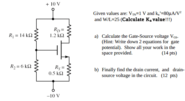

So what I started with is Vg=(R2/(R1+R2))Vdd - 10 = -7 Volts this is incorrect though I was told it is -4 V what did I do
Theoretically after I solve for this I would get Kn and Id. Then I would set up an equation to find Vgs.
The voltage across the potential divider R1+R2 is 20V. So the voltage across R2 is..
20 * R2/(R1+R2) = 6V
So the gate is 6V above the -10V rail which is -4V.
Likes SShashank117 and DODGEVIPER13
Thanks man
What equation were you given that includes ka', W/L and Ka? These are not standard terms in a JFET model so you need to give us your equation(s).
Oh yah I got it all figured out man thanks just had the test too hope I did well
