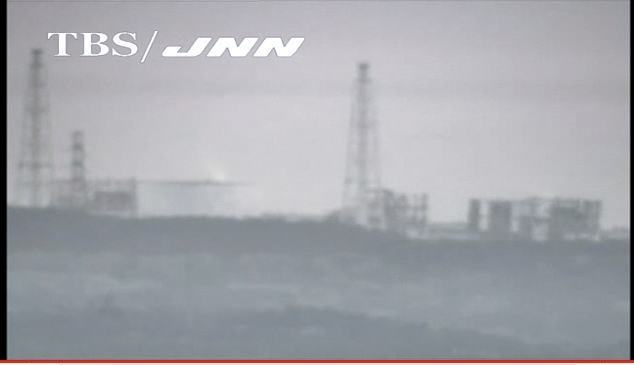

PietKuip said:
There are continuous emissions at the plant - see the smoke and the steam!
A kilobecquerel per square meter at such distances is a high level of fallout. It is consistent with wind directions. See the April 10 weather data for Mito http://www.wunderground.com/history...ml?req_city=NA&req_state=NA&req_statename=NA"
Thanks for the meteorological data website link. North-East winds are in line with your explanations. The rainfall seems to be 0 cm everyday so I don't think the rainfall data on that website are reliable, though.

I_P said:
Edit: Unit 3 experienced a rise in pressure on the 20th and TEPCO said they might need to vent it, however the pressure subsequently rapidly fell without intervention. I would be willing to make a serious bet that it 'self-vented' at that time leading to the radiation spike in the surrounding region.
There was also an observed outbreak of grey-ish smoke coming from Reactor 3 on the 21st.
Also, white smoke from Reactor 2 on the same day.

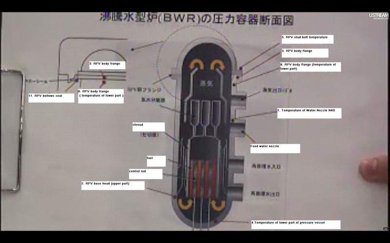

Samy24 said:
That was the thing I want to point at. But this would mean that TEPCO reports wrong data readings or the instruments are all gone crap.
I've mentioned this a few times back a hundred pages or so. The temperature sensors where damaged when they exceeded their operating point. I personally believe that the reactors that are not producing steam are actually at the cold shutdown point.
A good example of this was the photo's from the leak into the ocean they fixed. The water temperature leaking from the plant was supposedly >> boiling, yet the leak from the crack was not hot. High temperature water/steam in the RPV flowing out somewhere and Cold water leaking out of the plant? I doubt it. After weeks of "hot" water flowing out of the RPV to the crack everything would have been heat soaked and very little temperature drop would have occurred along the leak path.
[PLAIN]http://img859.imageshack.us/img859/3528/radioactiveleakfukushim.jpg
Air temperature is around 10-15C.. There should have been a large water vapor cloud pouring out of that leak.
Very large volumes shot from fire hoses all over the place, tsunami residual water, long flow paths and flow into already flooded trenches... why would the water leaking into the sea be expected to be hot? Air in unit 2 saturated from steam:
TEPCO says humidity inside the Number 2 reactor was 94 to 99 percent, fogging up the robot's camera lens.
The company says the humidity indicates that radioactive steam leaked into the building. It says it will need to install air conditioners to ventilate and clean the air of radioactivity before people can work there.
http://www3.nhk.or.jp/daily/english/21_04.html"
I doubt those things are 'cold' just yet.

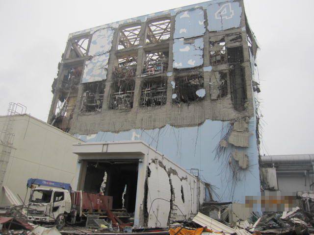

If the Company could start cleaning up Unit 4 to access the SFP, how do you remove oversized garbage without disturbing the pool?
Even if they could attempt one closed loop setup for the cooling of anything they are going to be up to their neck in contaminated water before they are done.
