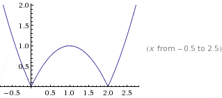

The above is the graph of f(x) = |2x - x2| .
For 0 < x < 2 , f(x) = 2x - x2 .
For all other values of x, f(x) = x2 - 2x .
By the way, f(x) is never negative.

But still I my first answer was sloppy. Actually the suggestions (specially the graph) helped me a lot! I tried solving it again and got the answer correct!
