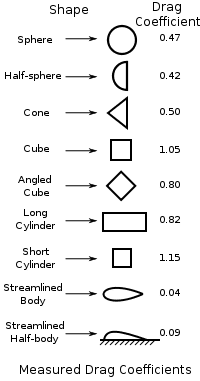

If it's a simple shape you can find it on the internet, such as this chart:
But if it's something more complex...which is pretty much anything, I don't think you can figure it out using paper and a pencil. Either through experiment, or maybe with some powerful physics program.
