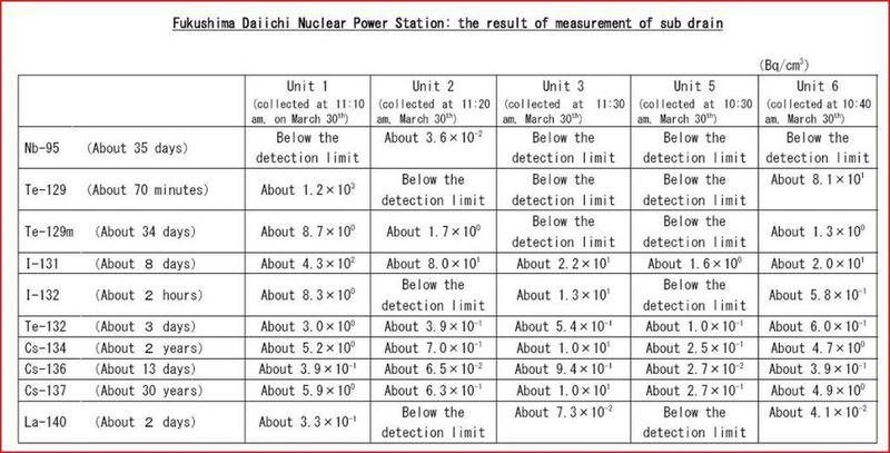

extracted from attached report for sea-water analysis - basement water would have have been done very similar. Any clues in this statement regarding their near-site measuring capabilities?
seen on this report :
Te-132 (3 days) : 2.2E-01 Bq/cm^3
I-232 (2hours) : 3.3 +00 Bq/cm^3
correct me if I'm wrong, but if I-232 is a https://www.physicsforums.com/showpost.php?p=3212764&postcount=1491", with a much shorter lifetime, shouldn't the activities be equal ? (because each Te-132 decay is quickly followed by the corresponding I-232 decay ?)
that's all so messy ...
