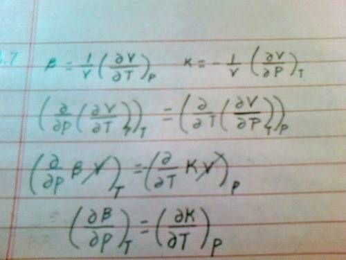

Actually it's a math question. Can I cancel V from both side in step 3? thx!
No you can't. You need to take their partial derivative.
http://farm1.static.flickr.com/122/367693621_f74963f0ea_o.jpg"
I've taken the derivative and substituted beta and k? into it. How to make it looks like step 6?
thx!
