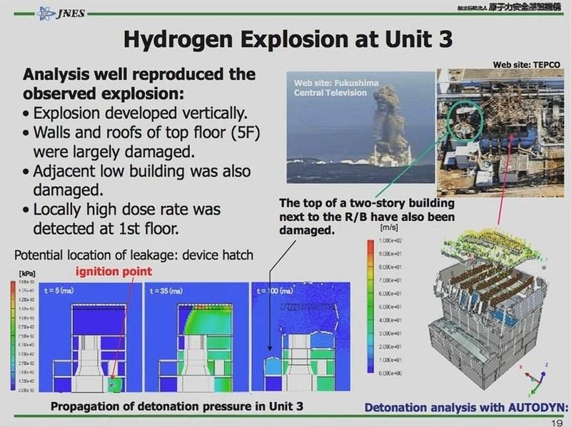

  • #9,678
I find it difficult to even believe that anyone with knowledge of physics looks at the blast and believes it was simply hydrogen burning. Or that it didn't damage the reactor, the fuel ponds, and almost everything else.
I mean, most of the building is simply gone. Not damaged, it's gone. The blast was so loud it was heard 40km away.
It should be possible to calculate exactly how much TNT it would take to create a blast like that. If Hydrogen alone can do that kind of damage, it might be time to change the physics books.
  • #9,679
robinson said:
It should be possible to calculate exactly how much TNT it would take to create a blast like [#3's]. If Hydrogen alone can do that kind of damage, it might be time to change the physics books.
This has been discussed before in this thread, and the amount of H2 needed was estimated. There were also photos of other industrial insallations wrecked by gas leaks.
Gas explosions are powerful indeed. In São Paulo (> 10 million hab) practically all kitchen stoves run on propane from portable tanks. There used to be ~1 explosion per day due to leaks from cracks in old hoses, worn-out valves, or improperly fitted connections. Typically the explosion would wreck the house or apartment. Now scale up from the volume of an average kitchen to that of the reactor's service space...
  • #9,680
Large amounts of the building remain intact.
I am no expert in explosions, but I see plenty of impressive hydrogen blasts on youtube, and I know that one of the issues with using hydrogen as a fuel is safety.
People can talk up the explosion at 3 all they like, and attempt to discredit thy physics knowledge of others, it does not prove anything or help their case.
Science is being done a disservice via a disproportionate amount of focus on visual evidence. Estimated total radiation release into the environment, as per the calculations used to come up with an INES level, suggests that the vast majority of contamination came from reactor 2. Yet this is hardly discussed, perhaps because there is too much judging of reactors by their cover.
  • #9,682
