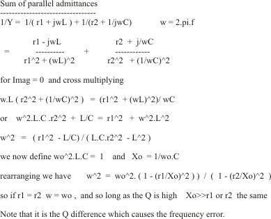

It shouldn't be the same, I don't think. If you read through the site Integral provided, it gives the form for the parallel circuit, which is slightly different, right?
For the circuit given with individual component resistances ( I was thinking of a simpler circuit) there is difference depending on your view. The circuit is both series and parallel at the same time ( the source impedance is infinite ). The impedance is minimal and of zero rectance as per your equation looking around the series loop.
However from the source viewpoint that is not the case except for r's very small
The expression for resonance ( meaning infinite parallel reactance is
w^2 .L . C = r1/r2 so if r1=r2 the equation is the same.
Ps I may have the r1,r2 reversed but you get the idea.
Ray
Final answer
attached is the simple analysis showing the error or ratio of resonances.
Ray
