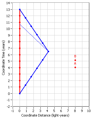

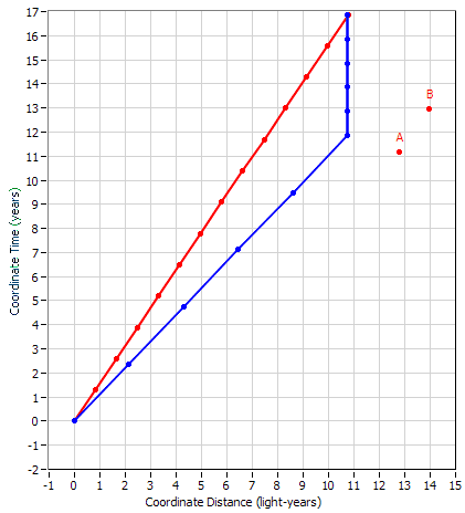

bobc2 said:
...I've prepared a set of sketches to help anyone interested visualize what is going on in the 4-dimensional universe with the twins in the context of simultaneity...
In an attempt to try to understand your sketches, I have redrawn my diagrams from post #23. I interchanged the colors of the twins to match what you drew and I eliminated the signals going between them for the same reason. In my diagrams, I mark yearly increments of Proper Time for both twins with dots so it was no problem adding in the black circles like you have in your Sketch I. Since simultaneity is marked by the Coordinate Time grid lines (or any other horizontal line), it was no problem adding the horizontal black lines and the blue circles placed on the traveling twin's world line. Here's what I've got so far:
But to add in the diagonal blue lines was not trivial because they are not coincident with the blue dots marking yearly increments of Proper Time for the traveling twin. Neither are they coincident with the blue circles. So what I did was transform from the IRF in which the black inertial twin is at rest to the IRF in which the blue traveling twin is at rest during the outbound portion of his trip. Then I added in horizontal blue lines going from the yearly increments of Proper Time for the black inertial twin and going over to the blue traveling twin's world line. These horizontal lines are simultaneous in this IRF. Here's that diagram:
Now, I look at the intersections of the horizontal blue lines in relation to the blue dots which enables me to know where to draw the blue diagonal lines on the first diagram. Here's the final diagram:
Now this leaves me with a question: what is the purpose of the blue circles?
[NOTE: I want to take this opportunity to point out an error I made in my first post (#7) of this thread. I incorrectly attempted to simplify the formula at the end of the post.]

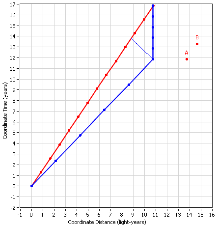

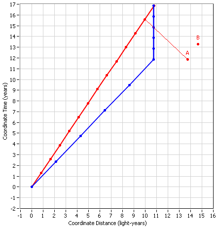

In the sketch below, I've added in a Red guy here in order to make a point about the interesting sequence of simultaneous worlds for the traveling twin as he does his turna-round. So, this additional red guy is at rest along with the black guy. As the Blue guy does his turn-around, the sequence of Black clock readings (as presented in the sequence of Blue's 3-D world cross-sections of the 4-D universe) progress into the future whereas the Red clock readings proceed into the past. As Blue enters the turn-around, the Black clock begins with event "black E" and at the end of the turn-around the last Black clock reading corresponds to event "black h." But, although Red's clocks begin with event "red E" (same simultaneous plane as "Black E") and end with event "red h", we see the sequence of Red clock readings going into the past along Red's X4 axis world line. The E, a, b, c, ... h designations identify the discrete hyperplanes (planes of simultaneity) in the movement through 4-D Space-Time of Blue as he progresses along his world line.
bobc2 said:
There seems to be confusion over the sequence of inertial frames associated with the traveling twin turnaround. I was simply pointing out what I thought was an interesting result for red clock readings as presented in the traveling twin’s sequence of inertial frames. So, here we will not be concerned about the period on the traveling twin's worldline during the turnaround. To avoid any further anguish over discretizing the turnaround, let’s just simplify the analysis by changing the focus away from the turnaround.
In the sketch below we show the same interesting feature by simply comparing readings on what I now show as the brown clock (red in the earlier sketch) as they are presented in the traveling twins two inertial frames, i.e., the purple frame (before turnaround) and the red frame (after turnaround). Notice that Event C presents a brown clock reading in the purple frame at the start of the outgoing trip of the traveling twin (the purple X1 axis represents the outgoing twin's simultaneous space at the start of his trip).
We show the beginning of the twin return trip as Event A (the traveling twin has just completed the turnaround and has started back home, i.e., the Red frame in the sketch). In this twin’s inertial frame the brown clock is presented on the worldline of the Brown frame as Event B.
When the traveling twin reaches Event D, the Event C is simultaneous with that same event (C simultaneous with D) in the twin’s inertial frame.
So, I am simply making the observation that as the traveling twin moves along his worldline, Event C is encountered at the start of the twin’s outgoing inertial frame before the Event B is encountered in the twin’s return inertial frame, even though as the Brown observer moves along his own X4 (time) axis, he (Brown) naturally experiences Event B before Event C. And Events D and C are simultaneous in the twin’s inertial frame. That’s all. No implications are drawn here—just an interesting observation for one to interpret however one pleases. Some may find nothing of interest here.
Well you have presented some intertesting observations here. I think there are some implications to be drawn.
Obviously there are some difficult complications regarding a non-inertial frame on several issues but certainly in principle we can assume a single co-accelerating frame for the traveler extending from the initial point to the turnaround.
Disregarding Born rigid acceleration for the turn around itself I for one have no real problem with taking your equivalence of MCIRF's for rough insights. Certainly such a frame would be at all times spatially aligned with the inertial CMRF's
So according to your interpretation at the outset (point O)the traveler at t'=0 at x=0 is simultaneous with event C with brown clock reading t=C at x=C
Then at event D on the travelers worldline at t'=D at x=D the traveler is simultaneous with event C
Later at event A on the traveler worldline at t'=A the traveler is simultaneous with event B at x=B , t=B (B<C)
So looking at this it means that event C is simultaneous with two different times at the same location I.e. at the traveler.
You may have no problem with this but I do.
SO at t'=0 there is a traveler clock at C that reads (C) t'=0 and at event A at t'=A there is also a traveler clock at C reading t'=A
So at a single location and a single instant you have two different observers from the traveler frame with different clock readings.
Quite clearly this is not merely counter intuitive it is simply impossible . Inconsistent with any fundamental conception of spacetime.

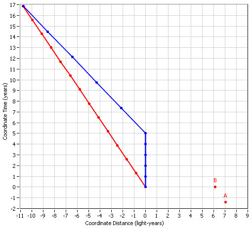

Then there is the intersection at event A with the earlier point on the brown worldline B
AT point O the traveler is simultaneous with C yet at later point A he is simultaneous with B which is earlier than C on the brown worldline.
Apparent time travel.
Even more , we can easily describe a situation where a traveler is momentarily co-located with a brown observer on the way out and then after turnaround is again co-located with the same observer at such an earlier time per your interpretation.
Clearly this physical interpretation is open for possible time paradoxes and not a viable possibility.
He receives a message from himself on the way out that he doesn't give the brown observer to forward until after turnaround , etc, etc etc,.
I think you would have to agree that every point in such a frame, even during acceleration,would not only be advancing forward in time but would actually observe all passing clocks also proceeding forward. That these apparent temporal shifts and impossibilities are artifacts of the conventions of Minkowski graphics and a misinterpretation of simultaneity.
They do not conform to any possible reality.
So as the man said"if you eliminate what is impossible , then what you have left ..."
What is quite possible and rational is this:
If we assume that the system clocks could instantaneously be conventionally synchronized during turnaround based on the traveler location as master ,then those outlying clocks would in fact be incremented forward.
So if the traveler clocks are being set ahead, this in a sense is equivalent to the brown clocks falling relatively behind. But the changes are all taking place in the traveler frame and are explicitly the result of human convention.
They are not the result of nor do they result in any change in the relationship between the world lines which both proceed blithely forward..
So it would appear that your illustration in fact provides a reductio ad absurdem argument countering the physical interpretation of planes of simultaneity you were promoting.

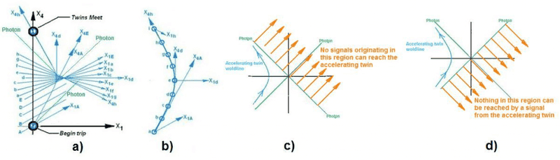

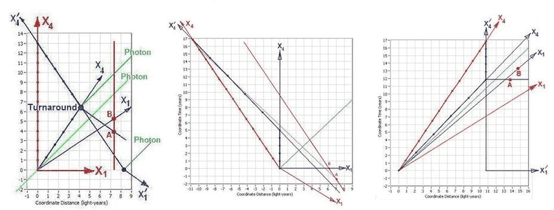

bobc2 said:
For anyone needing a little more background on the space-time sketches and the 4-dimensional universe concept, you can go to this earlier post that outlines the concept, beginning with post #19 (be sure you understand relativity of simultaneity--if not ask questions):
https://www.physicsforums.com/showthread.php?p=4138802#post4138802
I followed your link and found another similar diagram to the one that I asked about in post #161. Here's a clip of the first one:
I asked why the blue circles were placed where they were.

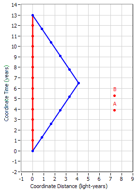

Now the clip from the link:
Again, I wonder about the placement of the blue circles, why are they placed differently this time?
I really don't understand why you put the blue circles in either place, they have no significance either way to the blue traveler. And what further doesn't make any sense to me is why you draw the blue lines intersecting with the black circles. Now I realize that the slope of the blue lines are indicating simultaneity for the blue traveler no matter where they are placed but you must have some reason to pick these particular lines.
What would make sense to me is if you placed the blue circles at the same increments of Proper Time for the blue traveler as what you picked for the black twin like this:
Now you can easily see the symmetry of Time Dilation between the IRF's of the two twins. Or does that matter to what you are trying to convey?
