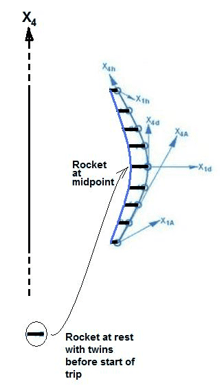

ghwellsjr, I tend to feel that nature has put the relativity of simultaneity into our physics and into our reality. Nature gave us a speed of light that is the same for all inertial frames. That is something that we experience because nature put in the photon worldlines so as to bisect the angle between X4 and X1 (thus, the Lorentz-Poincare'-Minkowski-Einstein simultaneous spaces). Nature gave us the worldlines to follow through space-time along with the simultaneous space in which to experience nature. These simultaneous spaces, for each different observer, are unique. Further, nature manifests the laws of nature through the continuous sequence of simultaneous spaces we experience as we move along our worldines. If you were one of the ficticious hyperdimensional observers looking at the block universe (pedagogically speaking--refer to earlier post with the hyperdimensional observers), these Lorentz simultaneous spaces would not have the same significance as for one of us 3-dimensional creatures. However, even the hyperdimensional creature could make out patterns of 4-dimensional objects that can be identified as unique patterns, from which laws of physics could be derived. And those laws would be recognized as associated with the Poincare' group of transformations.
Thanks again for the latest posts with the graphics--a good job as usual of summarizing the way we’ve been describing these inertial frames and coordinates. Here’s my summary that I was preparing just before your last post was presented (I was having some trouble with precision with one of the diagrams, so just hijacked yours). Again, my pictures are messy as compared to yours.
Now, see if I can summarize our differences in the consideration of implications arising from our understanding of the frame coordinates. I think a chief problem you and the others have with my understanding can be seen with the sketches a), b), c) and d) below. I began earlier in this PF thread by providing a representation of the turnaround region that discretized the otherwise continuously accelerating turnaround motion. I analyzed the continuous turnaround as a sequence of inertial straight line increments as shown in sketch a). Particularly objectionable to some was the sequence of momentary simultaneous spaces shown.
Sketch b) zoomed in on the turnaround, showing discrete events for which you could assign momentary velocities. This of course means that momentary simultaneous spaces would be assigned in accordance with the requirement that a photon worldline must bisect the angle between X4 and X1 at any moment (this assures photon speed c for all inertial frames).
This procedure then led to my taking note of the interesting feature of sequential X1 lines (corresponding to the simultaneous spaces) intersecting the worldline of a 2nd Red guy displaced to the right in the Red rest frame (see earlier posts) with a negative time sequence along the 2nd Red guy worldline. This of course in no way implied that time was going in reverse for the 2nd Red guy at rest in his own rest frame.
But, now I think one of the most objectionable aspects of my analysis of the accelerating twin is shown in sketches c) and d). Here, I am presenting the case for the twin in constant deceleration-acceleration. For in this case it is clear that no signals can be received by the twin from the region identified in sketch c). And no signals can be sent by the twin to any place located in the region shown in sketch d).
So I think our disagreement comes down to whether or not there can be any physical meaning attached to the twin’s momentary spaces that extend into regions for which no experimental signals can be exchanged. For the logical positivist the case is closed. No meaning should be attached. For the hard realist the reality is there and described by what events are presented to the simultaneous momentary spaces. For the soft realist, external reality exists independent of the observer, but a line is drawn for regions like this, where no signals can be exchanged.

I want to focus on this, as the way it bundles things gets at our disagreements.
1) To me 'relativity of simultaneity' means exactly that if two inertial observers in relative motion follow the same convention for synchronizing separated clocks at rest with respect to them, they will come to different conclusions about which events are simultaneous. Nothing more, nothing less. It does not mean, even for inertial observers, that there is some absolute nature to simultaneity. (I believe that Einstein used relativity of simultaneity strictly in the sense I describe, though that is only an argument by authority). You want to interpret relativity of simultaneity to mean each observer, at each moment, has a particular absolute simultaneity; rather than there is no such thing as an absolute sense of simultaneity.
2) Little need to discuss constancy of speed of light for inertial frames.
3) " Further, nature manifests the laws of nature through the continuous sequence of simultaneous spaces we experience as we move along our worldines." This I don't think follows from (1) or (2), nor do I see how it can be justified except as an article of faith. We do not experience simultaneous spaces nor are relativistic laws of nature expressed in terms of simultaneous spaces. For SR, they may take a simplest for in any global inertial frame. (Of course, in GR, global inertial frames don't exist, and global preferred simultaneity is a non-starter). No real observer's experience exactly matches a global inertial frame, but any observer can pick any such frame to make their analysis simpler. [Note: global, for spacetime, means global in space and time, obviously; a global inertial frame covers all of spacetime.]
  • #229
Here you are saying that the simultaneous spaces have no real physical meaning; the "interesting feature" is no more than that. But here...
...you are saying that the simultaneous spaces *do* have physical meaning. But the "interesting feature" is that the order in which some events are "presented to the simultaneous momentary spaces" is not well-defined; that's the whole point.
You can't have it both ways. If the simultaneous spaces don't have meaning, then the "interesting feature" doesn't lead to any contradictions, but you can't use simultaneous spaces to argue for your view of "reality". If you want to use simultaneous spaces to argue for your view of "reality", then the "interesting feature" is more than that: it's a genuine contradiction.

  • #232
Tendencies and feelings don't count in our physics and our reality. You have to come up with some hard evidence. I won't ask you for any because I already know it doesn't exist.
Nature gave us a value for the speed of light in all inertial frames which can be measured only by round-trip techniques.
Prior to Einstein, Lorentz and Poincare' had a perfectly good explanation for how light propagated at c only in a single inertial reference frame which was at rest with respect to a presumed ether. There is no experiment that could be performed to indicate that they were wrong. I won't ask you for one because I already know none exists.
You are claiming that it is possible to track the propagation of light. Please read the wikipedia article on The One Way Speed of Light.
Aside from the precision of my diagrams, do you feel compelled to mark them up because they are inadequate on their own? I have asked you why you are enamored to seek out a more complicated way to understand relativity than simply using a single Inertial Reference Frame (IRF) and then using the Lorentz Transformation process to create any other single IRF. Are you ever going to answer?
[edit: Expanded on the initial response to latest post by ghwellsjr]
The only way in Special Relativity that there are regions that cannot be reached by signals traveling at the speed of light is if the twin can travel faster than the speed of light. (Or if he doesn't exist at some points in time.) So I'd have to say your discovery is bogus.
I summarized my disagreement with you in post #217:
ghwellsjr said:
So if you want to consider any type of non-inertial frame or any frame that is a combination of IRF's, you need to be able to show that each observer continues to observe exactly what he observes in any IRF, plus you have to show the paths of the light signals remain consistent. And you have to do this for the entire scenario including all observers and all signals.
My question to those of you who are enamored by taking on this challenge: why does this appeal to you? What do you hope to learn? What do you think these other frames will show you that you cannot also see from any IRF?
Unless you can meet my challenge, I'm not going to share your enthusiasm for simultaneous spaces.

To answer gwellsjr, I see no purpose to non-inertial coordinates in SR except to make analogies with or bridge to GR. That, however, is strictly a personal preference. There is no problem with non-inertial coordinates as long as you know the requirements for valid coordinates and don't over-interpret them; in particular, a global inertial frame is possible in SR, but global accelerated frame (rather than coordinates) is not possible at all in SR any more than GR.
  • #238
