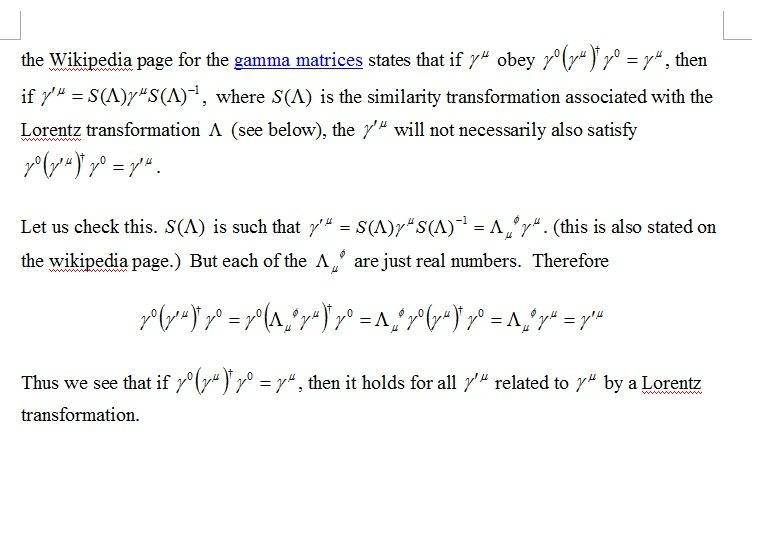

Is this section of the wikipedia page for gamma matrices wrong?
In summary: So I'm not sure if you answered my question or not.In summary, Wikipedia is not always right, but... if you have a question about the reliability of an article, always look at the View history section.
pellman
684
http://en.wikipedia.org/wiki/Gamma_matrices#Normalization
See the image below. Which of us is right: me or Wikipedia?
##\gamma^0## also transforms ... Wikipedia is usually pretty reliable.
You probably know all this, but other folks might not... :cool:
Wikipedia is not always right, but... if you have a question about the reliability of an article, always look at the View history section. That will show you the edits, vandalism, edit wars, last edit date, and all the other crap that goes on... lol
Probably the best place to look though, is the article Talk page... that tells you more or less how, and by whom the page was developed; you can also add your thoughts... Lol, it's kinda like here on PF... :biggrin:
Ha! I knew I missed something.
So am I reading the statement in the article correctly? In any particular frame we are free to choose a basis such that [itex]\gamma^0 (\gamma^\mu)^\dagger \gamma^0 = \gamma^\mu[/itex] but then when we Lorentz transform to another frame, this relation may no longer hold?

Wikipedia is (partially) wrong. The page says,
The hermiticity conditions are not invariant under the action [itex]\gamma^\mu \to S(\Lambda) \gamma^\mu {S(\Lambda)}^{-1}[/itex] of a Lorentz transformation [itex]\Lambda[/itex] because [itex]S(\Lambda)[/itex] is not necessarily a unitary transformation due to the noncompactness of the Lorentz group.
It's true that S(Λ) is not unitary. But, in place of that it does obey a condition sufficient to guarantee that the hermiticity conditions are invariant. Instead of SS = I, it obeys0S = γ0.
Start with γμ' = μS-1. Then
γμ' = (SγμS-1) = S-1† γμ† S = γ00 γμ† γ0S-1γ0 = γ00 γμ S-1γ0 = γ0 γμ' γ0
Likes 1 person
Bill_K said:
it obeys0S = γ0.
I haven't proved this but I checked it for a few cases. Seems to be the case. So this is to say that γ0 is invariant under Lorentz transformations? That's a surprise. And now the equivalence of the Dirac equation and its conjugate holds.
I will consider updating the Wikipedia article.

Thank you for the post vanhees71 but it isn't clear to me how it addresses the question of the thread.
The confusing point is that the γ0 in Sγ0S = γ0 is actually not the μ=0 component of γμ. It's a different matrix that is given a different name by more careful authors; for example, Weinberg and Srednicki both call it β.
Of course, [itex]\gamma^0[/itex] is the 0-Component of the matrix-valued four vector given by the Dirac matrices.
The relation [itex]\gamma^{0} (\gamma^{\mu})^{\dagger} \gamma^{0}=\gamma^{\mu}[/itex] is, however, indeed only valid for a special class of realizations of the [itex]\gamma[/itex] matrices, which btw. generate the Clifford algebra of the Minkowski vector space. It's only true for the Dirac standard representation and all representations that are derived from it by a unitary transformation. The [itex]S(\Lambda)[/itex] are not unitary for any Lorentz transformation that is not a pure rotation. Only the rotation group is realized as a unitary representation, not the boosts!
Of course, for a fixed representation you have
[tex]\gamma^0 (\gamma'{}^{\mu})^{\dagger} \gamma^0=\gamma'{}^{\mu},[/tex]
as has been correctly derived in posting #1, but generally you cannot put [itex]\gamma'{}^0[/itex] instead of [itex]\gamma^0[/itex] in this formula.

Ok, finally I checked it myself, and indeed Wikipedia is correct!
For all four [itex]\gamma[/itex] matrices the representation [itex]S=S(\Lambda)[/itex] of the proper Lorentz group MUST fulfill
[tex]S \gamma^{\mu} S^{-1} = {\Lambda^{\mu}}_{\nu} \gamma^{\nu}[/tex]
written in the convention of Peskin and Schroeder. The way Wikipedia writes it, is ok too, they just interchange [itex]\Lambda[/itex] and [itex]\Lambda^{-1}[/itex] in their argumentation.
Now, for the class of representations of the Dirac matrices, mentioned in my previous posting, you have
[tex]\gamma^0 (\gamma^{\mu})^{\dagger} \gamma^0=\gamma^0. \qquad (1)[/tex]
Further all representation matrices [itex]S[/itex] can be generated by representation matrices of the form
[tex]S=\exp \left (-\frac{\mathrm{i}}{4} \omega_{\mu \nu} \sigma^{\mu \nu} \right ),[/tex]
where
[tex]\sigma^{\mu \nu} = \frac{\mathrm{i}}{4} [\gamma^{\mu},\gamma^{\nu}], \quad \omega_{\mu \nu}=-\omega_{\nu \mu} \in \mathbb{R}.[/tex]
Because of (1) and [itex](\gamma^{0})^2=1[/itex] it follows that
[tex]\gamma^0 (\sigma^{\mu \nu})^{\dagger} \gamma^0=\sigma^{\mu \nu},[/tex]
which implies
[tex]S^{\dagger}=\exp \left (+\frac{\mathrm{i}}{4} \omega_{\mu \nu} \gamma^0 \sigma^{\mu \nu} \gamma^0 \right )=\gamma^0 \exp \left (+\frac{\mathrm{i}}{4} \omega_{\mu \nu} \sigma^{\mu \nu} \right ) \gamma^0 = \gamma^0 S^{-1} \gamma^0.[/tex]
Multiplying this from left and right with [itex]\gamma^0[/itex] gives
[tex]S^{-1}=\gamma^0 S^{\dagger} \gamma^0.[/tex]
Now from
[tex]\psi'(x')=S \psi(x)[/tex]
it follows
[tex]\overline{\psi'(x')}=[\psi'(x')]^{\dagger} \gamma^0=\psi^{\dagger}(x) S^{\dagger} \gamma^0=\overline{\psi(x)}\gamma^0 S^{\dagger} \gamma^0=\overline{\psi}S^{-1}.[/tex]
From this it follows that indeed [itex]\overline{\psi(x)}\psi(x)[/itex] is a scalar field as claimed.
But the relation, [itex]\gamma^0 (\gamma^{mu})^{\dagger} \gamma^0 = \gamma^{\mu}[/itex] is not invariant under the rep. of Lorentz transformations, because [itex]S[/itex] is NOT unitary. To see this explicitly let's play a bit:
What holds true is
[tex](\gamma'{}^{\mu})^{\dagger}={\Lambda^{\mu}}_{\nu} (\gamma^{\nu})^{\dagger} \; \Rightarrow \; \gamma^0 (\gamma'{}^{\mu})^{\dagger} \gamma^0=\gamma'{}^{\mu}.[/tex]
Now the left-hand side can be rewritten as follows:
[tex]\gamma^0 (\gamma'{}^{\mu})^{\dagger} \gamma^0=\gamma^0 (S^{-1})^{\dagger} (\gamma^{\mu})^{\dagger} S^{\dagger} \gamma^0 = \underbrace{\gamma^0 (S^{-1}) \dagger \gamma^0}_{S} \gamma^0 \gamma^{\mu} \gamma^0 \underbrace{\gamma^0 S^{\dagger} \gamma^0}_{S^{-1}}=S \gamma^0 \gamma^{\mu} \gamma^0 S^{-1} = S \gamma^0 S^{-1} S \gamma^{\mu} S^{-1} S \gamma^0 S^{-1}=\gamma'{}^0 \gamma'{}^{\mu} \gamma'{}^0 \neq \gamma'{}^{\mu}.[/tex]
QED.

You always use the fixed [itex]\gamma[/itex] matrices to build the covariant bilinear forms, as detailed in my posting for the example of the scalar density, [itex]\overline{\psi} \psi[/itex], i.e., the Dirac symbols are fixed quantities in the Dirac-spinor representation, like [itex]\eta_{\mu \nu}=\text{diag}(1,-1,-1,-1)[/itex] for the Minkowski pseudo-metric in the four-vector (fundamental) representation of the Lorentz group.
I get it now! If [itex]\psi[/itex] and [itex]\psi'[/itex] are related by a Lorentz transformation, then the matrices that appear in their respective equations are identical. The numerical form of the Dirac equation in the two frames is covariant.
What was confusing me was the relation [itex]S^{-1}\gamma^{\mu} S = {\Lambda^{\mu}}_{\nu} \gamma^\nu[/itex]. But what appears in the Dirac equation of the boosted frame is
[tex]S \left({\Lambda^{\mu}}_{\nu} \gamma^\nu \right) S^{-1} = \gamma^\mu[/tex]
I was thinking that the gamma matrices in the boosted frame were
[itex]S^{-1}\gamma^{\mu} S[/itex]. I think this was problem all along. Big thanks!
