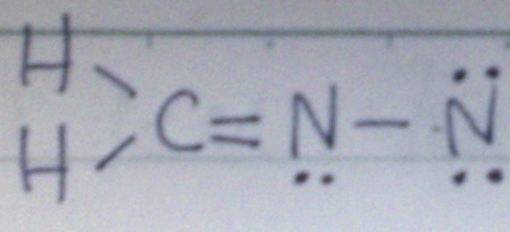

Many times, I find it hard to draw correct Lewis structure of molecules with nitrogen. For instance: the Lewis structure of H2CNN. I thought it should be double bond between C and N and single bond between N and N, like this:
But actually it's not. I have done many problems like this wrong.
Please help me out! Thx!

That's certainly a correct Lewis structure for this molecule. However, when viewed at as a representation of a valence bond structure, it may not be a structure with high importance.
The point is that the rightmost nitrogen has only a sextet. Transforming the lone pair of the central atom into a bond between the two nitrogens will lead to a structure fulfilling the octet rule on all atoms.
Thank you so much! It helps me a lot!
