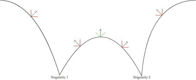

So in those terms, I am describing a stable area within the black hole where regular mater and information could exist.
In this one dimensional diagram, the red time cones mark the event horizon as I understand it. The green time cone is not tipped, but any light from it must enter one of the two event horizons. In one dimension I can see that the two singularities must merge, but in two dimensions they could instead orbit each other. Then the area near the green time cone would be stable, yet unable to reach the outside world.
There is a fundamental problem with this diagram: it attempts to depict "space" at an instant of "time". There is no way to depict the interior of a black hole (or multiple black holes) like that. You have to include time, because, for example, the two singularities are not at some "spatial location"; they are in the future. (More precisely, they are in the future for anyone inside the event horizon.) The same goes for the light cones: the "tipping" of the light cones is not purely spatial, because the light cones themselves are not purely spatial. They don't describe spatial paths of light: they describe *spacetime* paths of light.
You may be thinking of diagrams that show the exterior of a black hole as a sort of funnel shape, so that "gravity" causes things to fall towards the interior of the funnel. This is a permissible way of looking at the *exterior* of a black hole (the region outside the horizon) at an instant of time--although you can't draw light cones on this type of diagram even for the exterior. But you can't "extend the funnel" through the horizon to the interior; there is no way to represent the interior by that kind of diagram.
