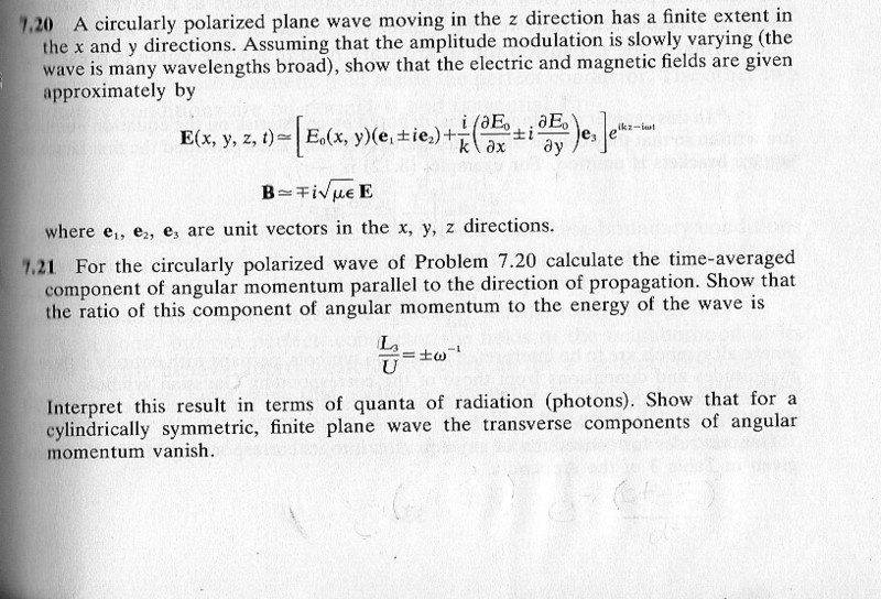

Spinnor said:
You don't have to as both the divergence of both E_x and B_y above are not equal to zero as they should be for a electromagnetic wave far from charges. ---> Both B and E need a component in the z direction?
See J.D. Jackson, 2nd ed. page 333, problem 7.20 for a solution closer to what you want.
Take Jackson's approximate fields for a circularly polarized wave of finite beam width, set ω and k equal to one, and multiply each by exp([z-t]^2) and see how well these new fields satisfy Maxwell's equations. Is this something the software Mathematica would handle?
Edit, that should be exp(-[z-t]^2) above.
Would a better attempt be to take Jackson's approximate solution above and multiply by an unknown function of (z-t), f(z-t), (where f(z-t) decays rapidly from the line z-t =0) and apply Maxwell's equations, one might then find differential equations the unknown function f(z-t) must satisfy?
Thanks for any help!
