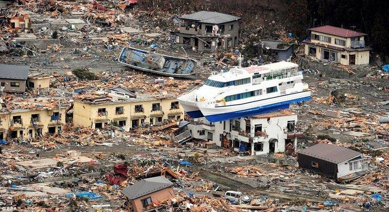

I wonder what they are going to do with the large ships that were carried inland by the tsunami. Leave them there are museums?

I suspect they'll be treated as debris... they'll definitely make some kind of memorial, but I suspect it would be more understated than a large vessel.
I mean, ships are built near the water. It would be rather hard to tow such a thing around.

I suspect the ships will have to be cut up and hauled off as scrap. Some of the boats might be hauled back to sea if they are repairable.
  • #32
I think leaving a large ship there as a memorial, with a museum built into it and all sorts of pictures of the disaster and tsunami devastation, would be rather beautiful.
Like this one: http://i.telegraph.co.uk/multimedia/archive/01852/ships-620_1852083i.jpg
It needs to be fixed up a little, but I wouldn't waste the tsunami's efforts, rather route the road around it and turn it into a spectacular tourist attraction. Japan is going to need tourist attractions ...
It would have to be removed, cleaned, drained and scrubbed first, then replaced. Knowing the Japanese I'd suspect something made from a ship, not a whole ship itself. One is a reminder, the latter is a momument.
