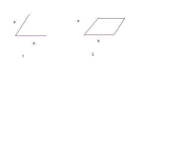

thanks for quick reply, done the translation on graph paper, tried to visualise as well..
Ive got a line from the origin going up to point i+4j, then i drew another line from the origin using vector b=3i.
do i get a triangular lattice? (only 5 possible types of crystal lattice in 2D)
You are welcome.
And you will not get triangular lattice. you must get a rectangular lattice.
This shows that you didn't translate your vector.
As you can see in the image given below.
In fig#1 two vectors a and b are sketched. And in fig#2 they are translated in order to make lattice.
Hope you got my point.
