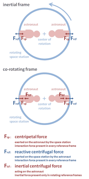

Here the rocket exerts a centripetal force on the mass, and the mass exerts a centrifugal reaction force on the rocket . The reactive centrifugal force acting on the rocket is a real force that appears in every frame.
Merry-go-round
Interaction forces that obey Newtons 3rd, and appear in every reference frame:
- centripetal force on the child, by the seat
- centrifugal force on the seat, by the child
Inertial force that doesn't obey Newtons 3rd, and appears only in the rotating reference frame:
- centrifugal force on the child

  • #81
Andrew Mason said:
The centrifugal effect in those examples is the result of a body's inertia. It is not a real force since it produces no acceleration.

Would you not agree that the merry-go-round must exert a centripetal force on the rider? If so, then the rider exerts and equal and opposite (in this case, outward) force on the merry-go-round. Simple as that. (Call that force what you will.)
  • #90
Andrew Mason said:
But my point is that the reaction force to the centripetal force that is applied to the merry-go-round rider is not a centrigufal reaction force.
The force on the seat, by the rider is centrifugal (= away from the center of rotation).
Andrew Mason said:
Rather it is always an equal and opposite centripetal force toward the centre of mass of the rotating system.
The specifiers centripetal & centrifugal refer to the center of rotation, not to the center of mass of some closed system for which momentum is conserved.
But if you are so obsessed with the center of mass, just put a second rider of equal weight on the opposite side. Both riders will exert reactive centrifugal forces on their seats. These forces point away from :
- the center of rotation
- the center of mass
You can't get more centrifugal than that.

I agree with Andrew here: The equal but opposite reaction to a real centripetal force is a real centripetal force. It is directed inward, not outward. You have to look at it all squinty-eyed and such to see the reaction force as outward.
A different example: Consider a binary star system; call the two stars A and B. The gravitational force exerted on Star A by star B is directed toward star B and thus toward the system center of mass. This force makes star A's trajectory curve inward toward the center of mass. It is a centripetal force. The gravitational force exerted on Star B by star A is an equal but opposite force and causes star B's trajectory curve inward toward the center of mass. It is also a centripetal force.
The same goes for your merry-go-round. The force on the merry-go-round when viewed from the perspective of an inertial frame is centripetal, not centrifugal.
I submit that there is such a thing as a reactive centrifugal force. The equal but opposite reaction to a real centrifugal force is a real centrifugal force. For example, the interactions between two positively charged objects are equal but opposite centrifugal forces.
This however is not what that nonsense wikipedia article is talking about.

  • #105
Doc Al said:
Forget the astronaut for a moment.
Or make it 2 astronauts, on opposite sides. Now we have no confusion about center of mass vs. center of rotation and momentum conservation
