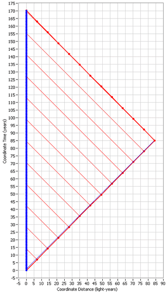

I don't think you have heard exactly that story before. If the astronaut flew at just under the speed of light (because he can't actually go at exactly the speed of light) to a star just one light year away and returned at the same speed, the people on Earth will have aged only about two years but the astronaut will have aged must less, maybe only a few days or weeks, depending on his speed so the chances are most of his family/friends will still be alive and they probably won't even notice the difference in their ages.
If you want the difference in their ages to be at least a hundred years (so that all the earthlings will have died) then the astronaut will have to travel to a star that is more than fifty light years away, let's say, about 84 light years. And let's say he is traveling at 99% the speed of light so as not to be in violation of the maximum speed limit. This means that it will take him 85 years of Earth time to get to the star and another 85 years to get back.
As the earthlings watch the astronaut travel away, they will see him through their telescope aging at a much lower rate than themselves but since it takes the light just about as much time to get back to them as it took for the astronaut to get to the star, it will take about double the time for them to see him arrive as it took for him to get there, which, of course means that if it took him about 85 years of Earth time to get there, they will be dead before they see him arrive. Since the star is 84 light years away it will take 84 years for the image of him arriving to get back to them so the total time will be 169 years by the time anyone could see him arrive at the star.
But a new generation of people will be able to see him arrive and they will see him having aged just twelve years since he left. Then they will see him turn around and come back home but this time they will see him age at a higher rate than themselves, in fact, they will see him age 12 more years in just under one year of Earth time.
So when it's all over, the astronaut will have aged 24 years while 170 years will have gone by on Earth since he left. He will still be alive but his family/friends will be dead.
Now what does the astronaut see of the earthlings? Well he will see them age at the same low rate that they saw him aging during his trip out. So during the twelve years that he ages during his trip out, he will see the earthlings age a little less than one year. But as soon as he turns around, he will see the earthlings age at a much faster rate than himself, actually more than 14 times his own aging rate. So during the 12 years that he takes coming back, he sees the earthlings accumulate about 169 years for a total of 170 years.
I have attached a spacetime diagram to depict the scenario that I have just described. The thick blue line represents the people on the Earth while the astronaut is shown as the thick red line. The dots mark off one-year increments of time for both of them. The thin blue line down at the bottom shows the image of the earthlings after one year traveling to the astronaut at the point of his turn-around. The thin red lines show the images of the astronaut at one-year increments of time as seen by the earthlings.
Hopefully, this will help you understand what's going on.

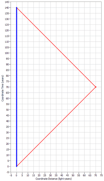

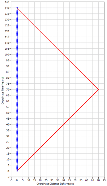

It occurred to me that there is another way to understand the problem. When you said that it only took the astronaut two years to travel to and from the far away star, you might have been talking about how long the trip took for the astronaut instead of for how long it took according to Earth time. It's very important when setting up a scenario that you state what frame the times and distances are specified in. So if the time and distance that you specified were in the astronaut's frame of reference during the first half of the trip, then it would be more correct to say that it was the star that traveled toward him from a distance of about one light year.
However, the principles that I and others have stated in previous posts apply either way, it's just the details that are different. I have made another spacetime diagram where the astronaut is traveling much faster, at 99.9898% of the speed of light. Then in one year of his time, it takes about 70 years of Earth time to get to a star about 70 light years away. The total trip takes 140 years of Earth time and 2 years of the astronaut's time.
At the beginning of the trip, each observer sees the other ones time progressing at 1/140 times their own which means the astronaut sees the earthlings have progressed through just 2.6 days by the time he turns around. Then during the last part of the trip, the astronaut sees the earthlings age at 140 times his own so they accumulate 140 years during his own time of one year. His total is one year plus one year or two years and their total is just over 140 years.
The earthlings would also see the astronaut age at 1/140 of their own rate during the first part of the trip. If they could live long enough, they would see the astronaut age just one year during 140 years of their time, then they would see him turn around and then they would see him age at 140 times their own rate so in just 2.6 days they would see him age one year. So, again, the astronaut's total age is 2 years while the Earth has gone through just over 140 years, guaranteeing that all of the astronaut's family and friends have died while he is gone.
