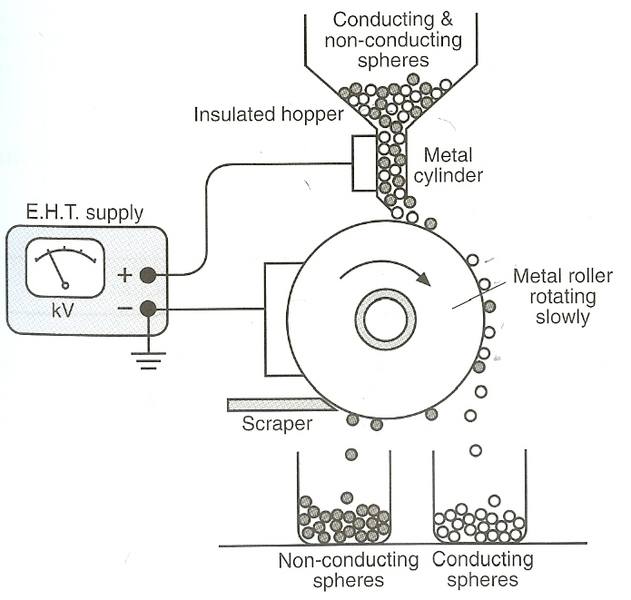

In summary, the figure shows a method where conducting and non-conducting spheres are separated using electrostatics. The conducting spheres fall off from the roller because the mobile charges (electrons) in the conductor readily flow, reducing the positive charge as it traverses the arc. On the other hand, the non-conducting spheres have to be scrapped off as the mobile charges do not move easily, causing them to hold onto the charge at the surface.
winston
The figure below shows an electrostatic method of separating conducting and non-conducting spheres
Why do the conducting spheres fall off from the roller while the non-conducting spheres have to be scrapped off?

What is the significance of conducting?
Not too sure... Is the answer something about non-conductors holding the charge at the surface but charges in conductors flow throughout the material. But I thought that all the spheres will become negatively charged upon contact with the negatively charged roller.
HELP. THANKS
Yes.
For the non-conducting material, the mobile charges (electrons) do not move so readily, so electrons will not flow onto the positively charged non-conducting material
In the 'conductor', the mobile charges (electrons) readily flow thus reducing the positive charge while the conducting material traverses the arc.
