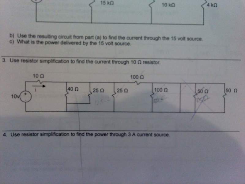

Use resistor simplification to find current across the 10 ohm resistor

Use resistor simplification to find current across the 10ohm resistor
V=ir p=vi

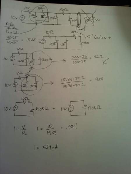

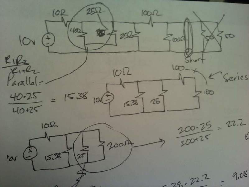

Any help you can give me is much appreciated. When I did it i got down to a parallel circuit with a 30ohm and a 100ohm but didnt get a round answer and i thought the teacher said theyre all rigged to come out right.

Can you show the work for your attempt?

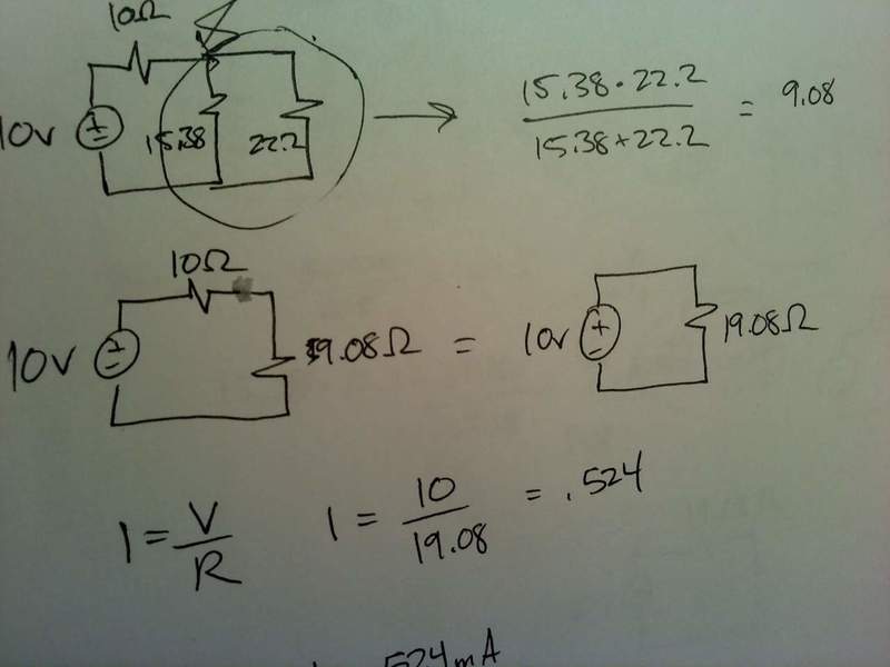

Yes, here is my work, sorry for not posting originally. I hadnt read the rules yet.

I get the same answer you do. The quicker way to do it (after you disregard everything distal to the short) is to observe you're left with 4 parallel resistances 40||25||25||200, the effective resistance of which is more quickly worked out with 1/R = (1/R1 + 1/R2 + 1/R3 +1/R4). Then add that to the 10Ω in series.

One of the 100Ω is shorted out. Total R is 40||25||25||100, in series with the 10Ω

So you have to take the reciprocal (inverse) of that sum to get the effective resistance, which is 1/0.115 = 8.696Ω. This has to be added to the 10Ω in series to get 18.696Ω, which is the total resistance in the circuit.
The current is therefore 10V/18.696Ω = 0.535A = 535mA, which should be the right answer.
The 524mA is using the "200" figure instead of the "100" figure as I originally did. This is a mistake, because one of the 100Ω is shorted out. It's easy to miss it because the short is "after" it (distal to it).
