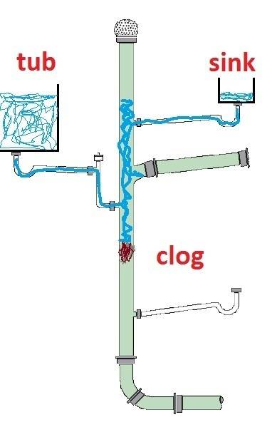

I'm going to give an illustration of what I think is wrong, and maybe someone who knows about plumbing can tell me if this makes sense.
Ok, let's say you have a pipe that's curved like the letter J. You pour water into the bottom part, but the water will stop going in at a certain point, because it's not going to climb up the pipe, so it will appear like it's clogged, but it's not. Is that what could be happening in the piping of my sink? For some reason the pressure of the water caused something to change so that it just won't flow?

If you are in an apartment block, most likely there is one drain pipe going vertically past all the floors, and your sink and bath pipes empty into it.
When somebody on the top floor empties their bath, they are probably filling up pipe the above the blockage, and when the water gets up to your level, it is backing up from the drain into your sink.

I am still thinking that the main sewer line is not plugged. When that happens water comes up in the bathtub or shower first.
More than likely there is an partial obstruction in the line just past the point where your sink ties into a branch line. The water that comes out has to be coming from a sink higher than the bathroom sink and that would usually be the kitchen sink.
On a second story job (pun) a plug could be beneath your floor level, but inside of a wall.
You will have to run a plumbers snake or have management do it. The best place to start is inside the pipe behind the sink where it goes into the wall.
Along with the plug there will be a lot of smelly stuff in there. There is decaying soap and hair in a bathroom sink drain pipe and black decaying garbage in a kitchen sink drain pipe. It can be really messy and the smell takes forever to get off of your hands.
So have some rubber gloves, a small plumbers snake, and new gaskets on hand, or call the management to get someone to come and do it.:wink:
