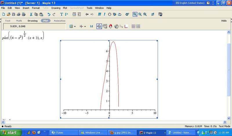

Sorry, it's just that I went to graphing directly using the function given and got:
That's why I said tilted parabola. But I see that after you split the integral you just get a simple u-sub and the area of a simple shape.

ThePatient's graph shows only part of the figure and has the axes with very different unit sizes.
