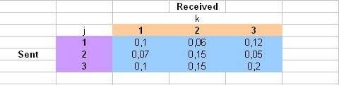

A Communication system transmits signals labeled 1, 2, and 3. The probability
that symbol j is sent and symbol k is received is listed in the table for each
pair (j,k) of sent and received symbols. For example, the probability is 0.12
that a 1 is sent and, owning to noise in the channel 3 is received.
Calculate the probability that the symbol k was sent, given that symbol k is
received, for k = 1,2,3, and calculate the probability of error incurred in
using this system. An Error is defined as the reception of any symbol other
than the one transmitted.

Or do the numbers inside the table represent conditional probabilitys?
P(received|send) ... for example P(3|1) = 0.12
I think you need to calculate p[1|1], p[2|2], p[3|3] separately using eqs. 1 and 2.
I thought about that but how do i get P(K) or P(J) ?
P(k)= P(k|1)+ P(k|2)+ P(k|3)
[tex]P(K_m) = P(J_n)*P(K_m|J_1) + P(J_n)*P(K_m|J_2) + P(J_n)*P(K_m|J_3)[/tex]
[tex]P(K_1) = 0.10 + 0.07 + 0.10 = 0.27[/tex]
[tex]P(K_2) = 0.06 + 0.15 + 0.15 = 0.36[/tex]
[tex]P(K_3) = 0.12 + 0.05 + 0.20 = 0.37[/tex]
a)
[tex]P(J_1|K_1) = \frac{P(J_1)*P(K_1|J_1)}{P(K_1)} = \frac{0.10}{0.27} = 0.37[/tex]
[tex]P(J_2|K_2) = \frac{P(J_2)*P(K_2|J_2)}{P(K_2)} = \frac{0.15}{0.36} = 0.4167[/tex]
[tex]P(J_3|K_3) = \frac{P(J_3)*P(K_3|J_3)}{P(K_3)} = \frac{0.20}{0.37} = 0.541[/tex]
[tex]P(J_n) = P(K_1)*P(K_1|J_n) + P(K_2)*P(K_2|J_n) + P(K_3)*P(K_3|J_n)[/tex]
[tex]P(J_1) = 0.10 + 0.06 + 0.12 = 0.28[/tex]
[tex]P(J_2) = 0.07 + 0.15 + 0.05 = 0.27[/tex]
[tex]P(J_3) = 0.10 + 0.15 + 0.20 = 0.45[/tex]
[tex]P(K_1)*P(J_1|K_1) = 0.3700 * 0.28 = 0.1036[/tex]
[tex]P(K_2)*P(J_2|K_2) = 0.4167 * 0.27 = 0.1125[/tex]
[tex]P(K_3)*P(J_3|K_3) = 0.5410 * 0.20 = 0.1082[/tex]
b)
[tex]Q = P(K_1)*P(J_1|K_1) + P(K_2)*P(J_2|K_2) + P(K_3)*P(J_3|K_3) = 0.3243[/tex]
[tex]P_e = 1-Q = 0.6757[/tex]
Is that correct? If yes how do i know that the values inside the
table are the values for P(J)*P(K|J) and not only for P(K|J)?
