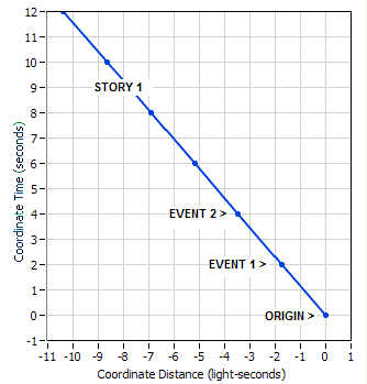

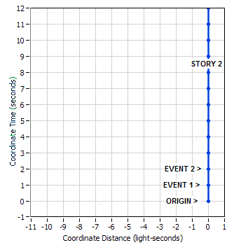

  • #81
John Huang said:
My point is a logical issue.
In above example, two systems have constant relative velocity so that the speed of time in the moving system t' and the speed of time in the stationary system t should be decided once we select the point O as the stationary point, and the O' as the moving point. Under this SPECIFIC arrangement, when we talk about a period of time for ONE SPECIFIC EVENT then we should have ONLY ONE event period Δt as recorded in the stationary system and ONLY ONE event period Δt' as recorded in the moving system.
Now, what SR claims is Δt' = Δt/γ and what LT claims is Δt' = γΔt for the ABOVE example. Logically speaking, this should not happen UNLESS γ=1, isn't it? How do you explain this logical issue?
You are correct that LT claims Δt' = γΔt when x=0. Here is a graph to illustrate a clock at rest at x=0. The blue dots represent ticks of the clock that occur every second:
Now we use the LT to transform the coordinates of all the events (the 1-second ticks represented by blue dots) into the coordinates of another frame moving at 0.866c with respect to the first frame. When we do the LT, we always call the original frame the unprimed frame and the new frame the primed frame:
Note that since the speed is 0.866c, gamma is equal to two. You can see that the first event which occurred at the time coordinate of 1 in the first frame occurs now at the time coordinate of 2 in the second frame, just like the LT formula indicates.
So far so good.
Now we want to see how to use the time dilation formula. Unlike the LT formula which applies to the coordinate times in two different frames, the time dilation formula applies to the relationship between the time (primed) on a clock compared to the coordinate time (unprimed), all in a single frame.
So let's apply the time dilation formula to the first graph where the speed of the clock is zero and gamma equals one. The formula says that the time on the clock is the same as the coordinate time and we see that because the spacing of the dots is the same as the spacing of the grid lines for the graph.
Now let's apply the time dilation formula to the second graph where the speed of the clock is 0.866 and gamma equals two. The formula says that the time on the clock will be one half of the coordinate time and we see that because the spacing of the dots is twice the spacing of the grid lines for the graph. In other words, the first dot after the origin, representing a clock time of one second occurs at a coordinate time of two seconds.
Got it?

  • #82
