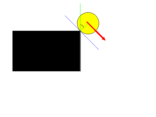

In the first diagram I have attached, the black = table, the yellow = ball, the green lines are the vertical line and the line connected from the edge of table to the centre of the ball, the blue line is the tangential line of the contact point of the ball, and the red line is the resultant force acting on the falling ball.
Let θ = the angle between the 2 green lines.
There are 2 cases I will discuss here. The first is when the table just exerts normal force on the ball but no friction. The second is the case when there is a friction force in addition to the normal force.
Case 1: No friction.
It is important for us to know the direction of the forces.
In my opinion, the normal force will be always pointing in the direction along the line going to the centre (the green line)! My explanation for this is, the table will never “feel”
The component mg sinθ but only “feel” the component mg cosθ.
Hence, the component mg cosθ will be canceled out, leaving mg sinθ as the net /resultant force.

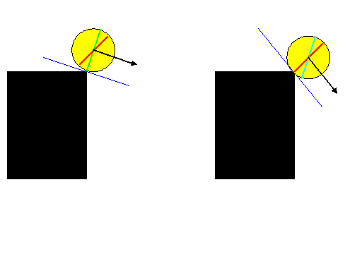

This is similar to the case in which a particle is falling down a hemisphere with initial speed = 0 at the top.
I also find that the ball will NEVER rotate; this is because there is no force acting along the blue line to give a torque about the axis passing through the centre of ball (and perpendicular to the page!).
However, the ball will not lose contact with the table initially, but at a special angle x.
We can visualize the process as in the second diagram I have attached.
Although the ball is not rolling, it still can get contact with the table! At time t, the ball “tends” to slide away the edge of table. In an extremely short duration ∆, the ball moves in the direction of mg sinθ and MEAWHILE fall down a little bit due to gravity (in this extremely small duration, it has lost the contact with the table, hence the net force = mg!)
After it fall a little bit (a very very small distance!), it will come in contact with the table again! But this time, the point in contact has changed to another point as illustrated in the diagram above!
So, what happen is: when the ball is in contact with the table, the CM of the ball will move and being accelerated in a curve such that the distance between it and the edge of the table is constant (the radius of the ball). In fact, the CM’s motion is the same as the motion of a particle falling down a hemisphere with initial speed = 0!
And, same as the particle, the ball will lose contact with the table at a special angle x, and you can get the value of x in the same way as you did for the particle!
(Hints: hen the normal force <0, i.e. when the mg <centripetal force required.!)
Case 2:
When there is friction (maybe because the edge of table has slightly sunk into the ball surface.) the friction will act to:
1) Decrease the net force; hence decrease the acceleration of CM.
2) Give the ball a torque, hence make it rotate!
3) When the friction force is large enough and constant, the contact point of the ball will
never move! This is same as when the boll is PIVOTTED at that point! In this case, the CM of the ball will rotate 90 degree around the edge of table. Its motion (acceleration and velocity) can be determined by using torque = mgRsinθ.
