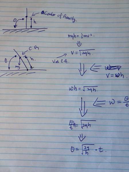

1. The problem statement, all variables and given/known data
find relationship between the angle and time of a tilted falling object
2. Relevant equations
any that is applicable
3. The attempt at a solution
As seen in picture below, and that's what I have done so far. It's a tilted object, only gavity and the support force(floor) are acting on it.
  • Is it valid? (using conservation of energy)
  • or do I need to do a force analysis?
  • if it's in-valid, what should I google for?
any input is appreciated, it's a real word problem, thanks

You wrote in your work that mgh = 1/2mv2. This is assuming that the falling stick is transferring all of its potential energy into translational kinetic energy.
But this isn't true, its potential energy is gradually being transferred into rotational kinetic energy. So your energy statement should have three parts: the total energy (that it starts with), the potential energy at some height h (or some angle theta), and the rotational kinetic energy.

that makes sense, so how do I fix the formula? from wikipedia, I found rotational kinetic energy is
Code:
 E=0.5Iω2
, so the new formula is something like:
Code:
mgh=mgh(1-sin(θ))+0.5mIω2
and it can be simplied as:
Code:
gh=gh(1-sin(θ))+0.5Iω2
Is this one valid now?
if it is valid, can you help me help out with I in the formula, as I have no idea what that is.

I don't know why you added an m into the term for rotational kinetic energy (in that middle code block).
And I is the moment of inertia. It depends on the body that is being rotated, and for a uniform rod it is 1/3mL2. Since we already defined h as being the distance from the end of the rod to the center of mass, what can you say L is? And what does the equation simplify into now?
(And what is ω? It may be helpful to turn it into an equivalent expression.)

as of the moment of inertia I=1/3mL2, assuming m is the mass, L is the length of the object, so the new equation is:
Code:
mgh=mgh(1-sinθ)+0.5Iω2, I=1/3mL2
mgh=mgh(1-sinθ)+(1/2)(1/3)m(2h)2ω2, ω=θ/t
g=g(1-sinθ)+(2/3)hω2, ω=θ/t
g=g(1-sinθ)+(2/3)h(θ/t)2
Is it valid now?

All of the work is correct with the exception of ω=θ/t, as ω (the rotational velocity) is the change in θ over the change in time, so it should read ω=dθ/dt.

this should be the last equation now?
mgh=mgh(1-sinθ)+(1/2)(1/3)m(2h)2ω2, ω=dθ/dt
g=g(1-sinθ)+(2/3)hω2, ω=dθ/dt
g=g(1-sinθ)+(2/3)h(dθ/dt)2

That all looks right to me
I attempted to solve this differential equation, but I got stuck trying to evaluate ∫√{csc(θ)}dθ, which wolfram alpha gives as involving an 'elliptic integral of the first kind' (http://www.wolframalpha.com/input/?i...Acsc%28x%29+dx) which I don't understand.
Maybe if the domain is limited to (0,π/2] the integral is easier.

The motion of the stick is more complicated than it might seem initially.
You can solve this with energy principles, as you are doing, or with force & torque.
If the contact of the stick with the floor is frictionless, then the C.M. (center of mass) of the stick falls exactly vertically downward.
If you assume that the bottom of the stick maintains contact with the floor (yes, I realize it's sliding) then you will find that the solution resulting from this will have that the angular velocity, ω, of the stick achieves some maximum, then decreases. This can't happen unless the floor pulls down on the end of the stick. Once you reach the point (*) at which ω is a maximum, ω will remain constant and the center of mass will fall with acceleration of g.
Added in Edit:
* At this point it's also true that the acceleration of the C.M. would become greater than g, downward.
Also, the top end of the stick will contact the floor first, before any other part does.
