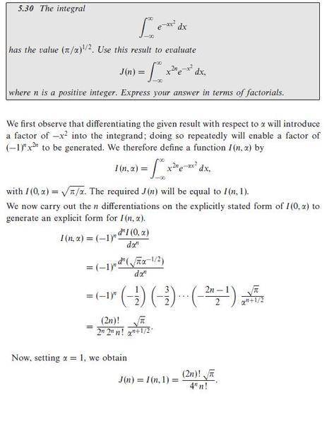

1. The problem statement, all variables and given/known data
The question is stated in the picture attached.
3. The attempt at a solution
I used a slightly different method, by making use of recurrence relations through integration by parts:
Jn = (2/2n+1) Jn+1
Jn = [1x3x5x....]/[2n] √∏
= [2n-1]! / [2n-1 * (n-1)! ] = (2n)! / (2n * n!)
But the answer had 4n instead at the bottom... Not sure where I went wrong.

Your working is mostly correct unscientific, you just left behind a factor of [itex]2^n[/itex] on the denominator.
Where you had Jn = [1x3x5x....(2n-1)]/[2n] √∏, this is correct.
Next you can replace the "odd factorial" with,
[tex](2n-1)(2n-3) \ldots 1 = \frac{(2n-1)!}{2^{n-1} (n-1)!} = \frac{(2n)!}{2^{n} (n)!}[/tex]

[tex]1 \cdot 3 \cdot 5 \cdot \cdots \cdot (2m+1) = \frac{(2m+1)!}{2 \cdot 4 \cdot \cdots \cdot 2m} = \frac{(2m+1)!}{2^m m!}.[/tex]
Thus [tex] \frac{1 \cdot 3 \cdot 5 \cdot \cdots \cdot (2m+1) }{2^m} = \frac{(2m+1)!}{4^m m!}.[/tex]

Oh damn! I forgot about the 2n below initially! Can't believe I missed it despite checking numerous times. Sorry, I will check my working more thoroughly next time!

Splitting the integral up and setting [itex]x=\sqrt{t}[/itex] yields the integral
[tex]2\int^{\infty}_{0}\frac{t^n e^{-t}\,dt}{2\sqrt{t}}[/tex]
which gives
[tex]\int^{\infty}_{0}t^{n-1/2} e^{-t}\,dt = \Gamma(n+1/2)[/tex]
The Lagrange duplication formula can be applied here:
[tex]\Gamma(n)\Gamma(n+1/2)=2^{1-2n}\sqrt{\pi}\Gamma(2n)[/tex]
For integer n, this simplifies to
[tex]\Gamma(n+1/2)=\frac{2(2n-1)!\sqrt{\pi}}{4^{n}(n-1)!}[/tex]
which is equivalent to
[tex]\Gamma(n+1/2)=\frac{(2n)!\sqrt{\pi}}{4^{n}n!}[/tex]
This gives the result in the paper. Usually, I try to work integrals that have a power of a variable and the exponential function in it using the Gamma function. It worked in this case as well.
