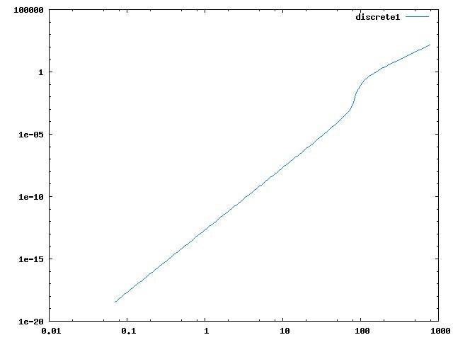

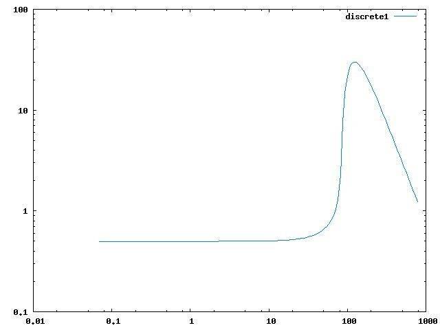

I'd believe we are all using free software, so we can try maxima or wxmaxima
Code:
f(x,r,g):=(1+x-2*x^2)*sqrt(1+x^2-2*x)/((1-x*r)^2+g);
GF:1.16637*10^-5;
decay(m):=9*2*GF^2*m^5/(192*%pi^3)*(quad_qags(f(x,(m/80.4)^2,(2.14/80.4)^2), x, 0, 1)[1]);
still, I am having http://www.math.utexas.edu/pipermail/maxima/2007/007063.html :frown:
Really! The bad interface between numerics and analytics in maxima, 20 years later, is disgusting. I first used Macsyma, the VAX VMS version, in 1989.
Anyway:
Code:
h(m):=quad_qags(f(x,(m/80.4)^2,(2.14/80.4)^2), x, 0, 1);
yy:makelist(float(exp(i/15)),i,-40,100);
yh:makelist(h(z)[1],z,yy)$
plot2d([discrete,yy,yh]);
plot2d([discrete,yy,yh],[gnuplot_preamble,"set logscale x; set logscale y"]);
plot2d([discrete,yy,yh],[gnuplot_term,jpeg],[gnuplot_out_file,"out.jpg"],[gnuplot_preamble,"set logscale x; set logscale y"]);

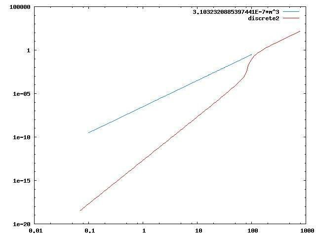

You are contemplating the mystery of symmetry restoration :bugeye:: as the mass increases beyond M_W, the decay is effective into three bodies instead of four and the integrand h(m) starts to deliver a dependency on m^-2.
Observe the second attached plot, and consider what should happen if the mass of W were smaller, while you start still from the top mass scale... the cubic line should prolongue, the change to quintic happening to lower energy. Ideally, a limit can be taken where the mass of W is null and no change to quintic happens; in this limit, isospin symmetry is restored, as the elders told us in the school.
For an excursion into the unknown, compare the third plot here with the one discussed in http://dorigo.wordpress.com/2006/09/14/a-mistery-behind-the-z-width/. Note that here we are using GeV, while that plot uses MeV. Note also we are not including QCD, neither here not in the other plot, and that here we are including the factor 9 of the different decays as if all the masses were zero except the top. The coincidence with the cubic line discussed in that entry is stronger if this factor 9 is not used.
EDIT: If you want to pursue further the numerical investigation, quad_qag will be better than quad_qags.
What happens is that the fork here sits nice and mystically about a factor ten inside of the fork there. Thus the use of this fork to calculate the breaking of isospin in decay widths of a isomultiplet works nicely in the qualitative (dependence on M^2) but fails about one or two orders of magnitude in the quantitative.
The quintic leg would meet exactly the muon cross if the factor nine were progressively removed as the energy crosses the thresholds for the decay of virtual W into cs (-3), tau-nu (-1), ud (-3) and muon itself (-1). The exact calculation becomes lengthy because of the CKM mixing.
But there is not a clear way for the cubic leg here to reach the experimental cubic leg. If we enable QCD in the formula here, the decay width decreases (see Jezabek and Kuhn 1993).
In any case, note that the decays of the electrically neutral isospin partners of charged mesons are into photons, so it had been very surprising to get a match with only SU(2) weak and without the U(1) EM group. Still, I do not know yet how to enter it into the Z0 mystery line, so I guess that the detour stops here and we can go back to regular schedule.
