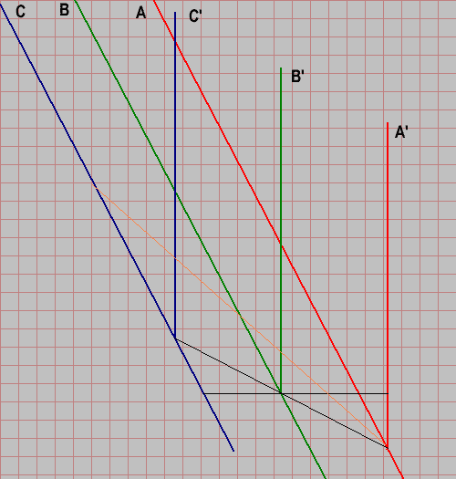

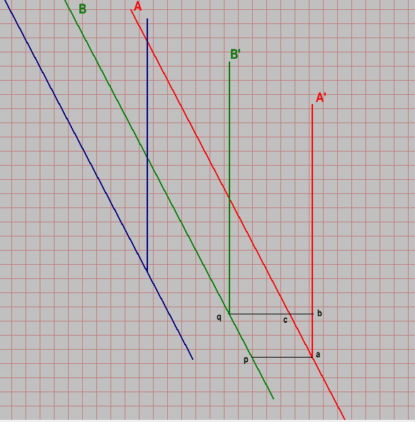

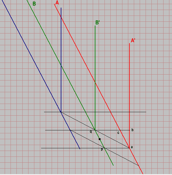

  • #79
Please, look at this too
DaleSpam said:
mananvpanchal said:
[itex]t'=\tau - 0.75 d, \mbox{if } \tau \ge 0[/itex]
As [itex]\tau[/itex] increases, desynchronization between two clocks decreases.
This is an incorrect reading of the expression. The desynchronization between two clocks remains constant as the [itex]\tau_d[/itex] increase (for [itex]\tau_d>0[/itex]).
For example, consider the clocks [itex]d=0[/itex] and [itex]d=1[/itex]. At t'=100 we have [itex]\tau_0=100[/itex] and [itex]\tau_1=100.75[/itex] so the desynchronization is [itex]\tau_1 - \tau_0=0.75[/itex]. At t'=200 we have [itex]\tau_0=200[/itex] and [itex]\tau_1=200.75[/itex] so the desynchronization is [itex]\tau_1 - \tau_0=0.75[/itex].
Here, I am talking about [itex]t'[/itex]. I have take here [itex]t'_a=\tau - 0.75 d_a[/itex], [itex]t'_o=\tau - 0.75 d_o[/itex] and [itex]t'_b=\tau - 0.75 d_b[/itex]. So as [itex]\tau[/itex] increase deference between [itex]t'_a[/itex], [itex]t'_o[/itex] and [itex]t'_b[/itex] decreases. And that is why I have used subscript with [itex]t'[/itex].
[itex]t[/itex] is R's clock's reading for R.
[itex]\tau[/itex] is train's clocks (A, O, B)'s reading for R (The reading is same, so train's clocks is synchronized for R) ([itex]\tau[/itex] is not train's clocks reading for O, so it cannot have different values as per [itex]d[/itex]).
And [itex]t'[/itex] is trains clock's reading for O (We have boosted here the train clocks reading for R ([itex]\tau[/itex]) to train's clocks reading for O ([itex]t'[/itex])) (Train's clocks is not synchronized for O, so [itex]t'[/itex] should have different values as per [itex]d[/itex]). So actually subscript should be used with [itex]t'[/itex] not with [itex]\tau[/itex].

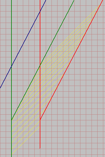

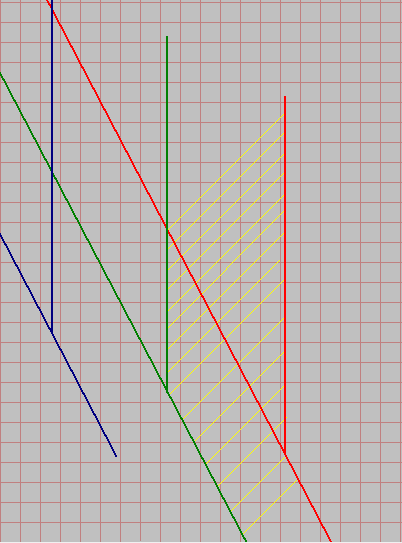

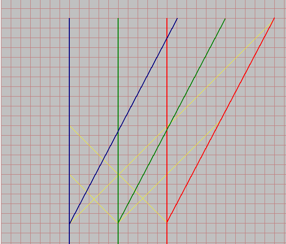

  • #81
DaleSpam said:
As per the OP, the clocks are initially synchronized in R's frame such that at t=0 they all read 0. So, we can calculate the time displayed on each clock, τ, using the spacetime interval. Solving for t we get:
[tex]t=\begin{cases}
\tau & \mbox{if } \tau \lt 0 \\
1.25 \tau & \mbox{if } \tau \ge 0
\end{cases}[/tex]
You have defined here [itex]\tau[/itex] is time reading of train's clocks for R.
Suppose, there is only one clock in train. When train is at station the R, O and the clock have same space component in platform co-ordinate system. Now at t=0 train's speed is 0.6c. So we can draw the world line of the clock like this.
We can easily see that when 1.25 reading in R's clock for R, O's clock reading is 1 for R. And when 1.25 reading in O's clock for O, R's clock reading is 1 for O. So moving O's clock slow down with respect to R, and moving R's clock slow down with respect to O. Here you have used simple transformation formula [itex]t = \gamma \tau[/itex], because space component is 0 at initial stage. We get one value for [itex]t[/itex] for [itex]\tau = 1[/itex] and [itex]x = 0[/itex].
Now, if we put another two clocks at train's front and train's end. And you have said that the the clocks would be dilated for R at same rate and would remain synchronized for R. So, as per your saying, the world lines of the three clocks would look like this.
You can see that lines of simultaneity of R's frame says that clocks is dilated with same rate and clocks is synchronized.
But, do you notice what is wrong with this diagram?
We cannot use the [itex]t = \gamma \tau[/itex] formula to calculate readings of front clock and end clock. Because, now the space component is not same for R, front clock and end clock. We have to consider space component in calculation. Here space component is not 0 of the new two clocks at initial stage. Another thing is you can see in above diagram that difference between space component doesn't change after frame changing. But, if we transform some (t, x)=(0, x) point to another co-ordinate system we will get (t', x')=(0, x'), where x ≠ x' surely. So after transformation space component of clock should be changed.
So, we have to use this equation [itex]t = \gamma (\tau - 0.6x)[/itex]. We get three values for [itex]t[/itex] by putting ([itex]\tau = 1[/itex], [itex]x=-1[/itex]), ([itex]\tau = 1[/itex], [itex]x=0[/itex]) and ([itex]\tau = 1[/itex], [itex]x=1[/itex]) in equation. So R will see [itex]\tau = 1[/itex] at different different time in his frame. The above space component problem will also be solved with this equation. This scenario can be described by below image.
We can easily see that lines of simultaneity of O's frame says that train's clocks is synchronized for O, but not for R. So, train's clocks would not be synchronized for R.

  • #92
mananvpanchal said:
When [itex]\tau_a = 0[/itex], value of [itex]t_a=0.75[/itex]
When [itex]\tau_o = 0[/itex], value of [itex]t_o=0[/itex]
When [itex]\tau_b = 0[/itex], value of [itex]t_b=-0.75[/itex]
I know that this calculation creates gap between world line and overlapping of world line. And I know that is strange to you. So, please see below image in which I have tried to show smooth acceleration of three clocks.
We can easily see that for [itex]t < 0[/itex], the clocks is at rest in R's frame and lines of simultaneity says that the three clocks are synchronized in R's frame.
Now at [itex]t = 0[/itex] clocks starts accelerating. And at some time [itex]t = t_1[/itex] the clocks achieves 0.6c speed and after this clocks moving with the constant speed.
Now, you can see lines of simultaneity of O's frame are not parallel during acceleration phase [itex](0 \le t < t1)[/itex]. And lines of simultaneity of O's frame are parallel for [itex]t < 0[/itex] and for [itex]t \ge t_1[/itex].
Space axis and time axis is slowly skewed during acceleration. And after achieving constant speed it will not be skewed more. Lines of simultaneity are always parallel to space axis, so it is also skewed with space axis.
Lines of simultaneity of any frame indicates synchronized clocks in that moving frame.
So, lines of simultaneity of O's frame indicates synchronized clocks in O's frame. But, lines of simultaneity of O's frame are not parallel to lines of simultaneity of R's frame. So, O's clocks which is synchronized in O's frame is not synchronized in R's frame.
Now, please see below image in which I have tried to show what you are saying.
You can easily see that it solves the purpose "Clocks of O's frame are synchronized in R's frame".
But, to solve the purpose, the diagram creates some problems.
- Only time axis is skewed. Space axis is not skewed.
- Space axis is not skewed, so space scale of O's frame remains equal to space scale of R's frame. Which should not be.
- Clocks is synchronized in R's frame, but the diagram cannot show how the clocks is not synchronized in O's frame.
Now, please tell me. Do you agree that after finishing acceleration the lines of simultaneity of O's frame are skewed for R's frame?
If you find that I couldn't show your idea in second diagram then please provide me your diagram.

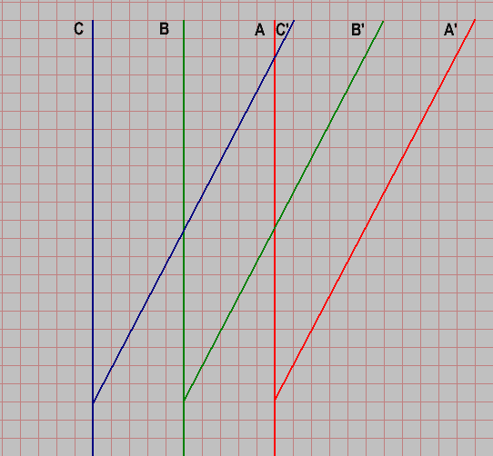

  • #101
These diagrams might help. They are essentially the same as the one posted by Dalespam in post #95 but show the events from both sets of observers POV.
In the first diagram the stationary frame is the comoving observers A,B,C. The primed observers begin moving away simultaneously in the unprimed observers frame.
The second diagram is the rest frame of the primed observers, and it is clear that their clocks are no longer synchronised because they did not begin their motion simultaneously in their frame.
The diagrams are completely clear and show what is happening. There are no contradictions or paradoxes.
The mistake in your original diagram in post #1 is that you tried to make the moment of departure simultaneous in both frames, which it is not.

OK. The speed is 0.52c in the diagram below which has the lines of simultaneity. You can read off the answers from this.
Now, can you calculate for me what is the value of [itex]t_{a'}[/itex], [itex]t_{b'}[/itex] and [itex]t_{c'}[/itex] at [itex]t_{abc}=0[/itex]? (please, take origin on B's world line)
Can you rephrase this in terms of proper times ? [itex]t_{abc}=0[/itex] is only true in the unprimed frame.
I've run out of time. Try calculating proper times by triangulation from the diagrams using dtau^2 = dt^2-dx^2.

mananvpanchal said:
- You said my modified diagram (modified by you) shows that clocks is not synchronized for O. Then how does the modified diagram shows that clocks is synchronized for R?
First, do you agree that the clocks each read 0 at the black dots in your scenario?
If so, then along each worldline simply find points of equal spacetime interval from the black dots and note that they occur simultaneously for R.
If not, then please mark where each clock reads 0 clearly on your diagram.
mananvpanchal said:
- I cannot understand that why you don't want to understand this: If a clock is at rest in a frame then its proper time (what time interval it has covered in the frame) is equal to co-ordinate time of the frame (because covered space interval is zero in the frame).
Again, my watch and my desk clock are both at rest in my frame, and they have different readings of proper time. One says 1:19 and the other says 1:21. So it is not possible for them to both be equal to the co-ordinate time. They are not synchronized. This disproves your claim by counterexample.
You are focusing on the fact that they are running at the same rate as coordinate time in my frame. However, that is not relevant to determining synchronization. Two clocks may be running fast or slow and yet be synchronized. They may be running at the correct rate and yet not be synchronized. You are mixing two separate concepts.
mananvpanchal said:
- I cannot understand that why you don't want to understand this: Line of simultaneity is the line on which, two events occurred, called simultaneous events. So short hand and long hand of clocks on the line meets at 12 must be simultaneous events on the line of simultaneity. So clocks on the line can be called synchronized. If clocks on line of simultaneity is not synchronized then what is other method you have to prove that two events occurred on the line of simultaneity is simultaneous events?
You are again confusing simultaneity with synchronization. Simply because you can draw a line of simultaneity on a spacetime diagram does not imply that all clocks will read the same on that line of simultaneity unless the clocks are synchronized.
The procedure for synchronization was given by Einstein. In your problem setup you stated that the clocks were initially synchronized in the unprimed frame. Meaning that Einstein's procedure synchronization procedure was carried out initially.
Because the clocks were synchronized in the unprimed frame, and because their velocity profile is the same in the unprimed frame at all times, they remain synchronized in the unprimed frame, as I proved. Because they are synchronized in the unprimed frame, they are not synchronized in the primed frame frame, as I proved.
mananvpanchal said:
- Accelerating scenario can be made up using too many small inertial frames changing. My diagram shows how lines of simultaneity of O's frame becomes unparallel to space axis of R's frame (during acceleration and after acceleration). So, clocks on the lines of simultaneity becomes desynchronized for R. But, lines of simultaneity is always parallel to space axis of whatever small inertial frame in which O exist at that time. So, clocks on the lines of simultaneity remain synchronized for O.
No they don't. Look at the gaps between your "sweeping" lines of simultaneity. Do those gaps look like they are marking equal spacetime intervals for each clock? Please answer this question in bold directly.

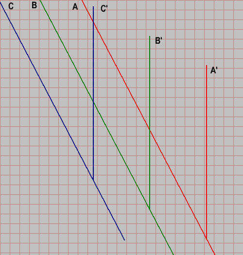

mananvpanchal said:
- I have proved that train's clocks is synchronized for O and not synchronized for R using diagram and maths (LT equation).
No you haven't. You first drew physically impossible diagrams, then you misinterpreted your own diagrams. Your math is incorrect because you tried to use a transform to specify a problem rather than to transform it into a new reference frame.
Suppose, that at some [itex]t_a=t_b=t_c=-0.001[/itex], value of [itex]t'_a=t'_b=t'_c=-0.001[/itex] too. But, at [itex]t_a=t_b=t_c=0[/itex], what should be the value of [itex]t_a=?, t_b=?, t_c=?[/itex]
I think I don't need difference of proper time [itex]d\tau[/itex] and difference of co-ordinate time [itex]dt[/itex]. Please, clarify your point if I have misunderstood this.
