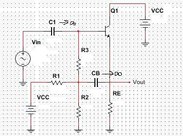

Hi!
Here is my task:
Calculate voltage gain Av and current gain Ai for circuit on scheme .
I don't know how to calculate Ai. I got that Av=-gm*rce*Rc*Rl/(Rc*Rl+rce*(Rc+Rl)) and it matches with solution given in my textbook.
I know that Ai=Iout/Iin but which current is Iout? Ai should be gm*rce/((rce+Rc*Rl/(Rc+Rl))*(1/R1+1/R2+1/rpi)).
