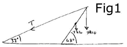

A wrecking ball (weight = 5910 N) is supported by a boom, which may be assumed to be uniform and has a weight of 2820 N. As the drawing shows, a support cable runs from the top of the boom to the tractor. The angle between the support cable and the horizontal is 32°, and the angle between the boom and the horizontal is 48°. Find (a) the tension in the support cable and (b) the magnitude of the force exerted on the lower end of the boom by the hinge at point P.
I have been having trouble trying to finf the tension, not sure how I originally thought to just do the sum of the torques but it's not coming out. I thougit was just T = 3/4 sin 90 ? very confused?

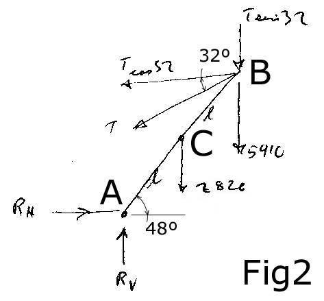

You need to construct a FBD, then do,
ΣFv = 0
ΣFh = 0
ΣM = 0
where M is a moment, or torque.
This is how I set up my equation Torque sum =
-2820N (L/2)sin 138
+ T(3/4)L sin 90
- 5910sin138 =0 and I get 6530 ?
What I realized later was that I think I'm supposed to use the 32 angle for the tension force in some way but I'm not sure. I hope m attachment isn;t pending for very long it's a good description
I think I have an idea of what your attachment will look like.
Is it like mine ?
http://img476.imageshack.us/img476/4256/mkm10sa.jpg
If so, then the FBD could be something like my 2nd attachment
http://img476.imageshack.us/img476/5760/mkm26qe.jpg

wow It's exactly like your second attachment . I actually had the Tension facing outward perpendicular to the support cable but maybe I was wrong.

Tension is always in the direction of the cable (or whatever else is providing the tension).

I don't understand your tension formula. What is the v ? There is no velocity involved.
Do what I suggested in my first post. Do a balance of forces, both horizontal and vertical. Then do a balance of moments (or torques).
ΣFv = 0
ΣFh = 0
ΣM = 0
When doing the sum of torques, Pick a point, A say, and take the moments of every force about this point. All the forces are listed in Fig2. Remember that the tension T, in Fig2, should be ignored since it has been resolved into horizontal and vertical components, Tcos32 and Tsin32 respectively. And it is these two forces that should have their moments taken, not T.
should the angle between the boom and the cable be 48-32=16?
