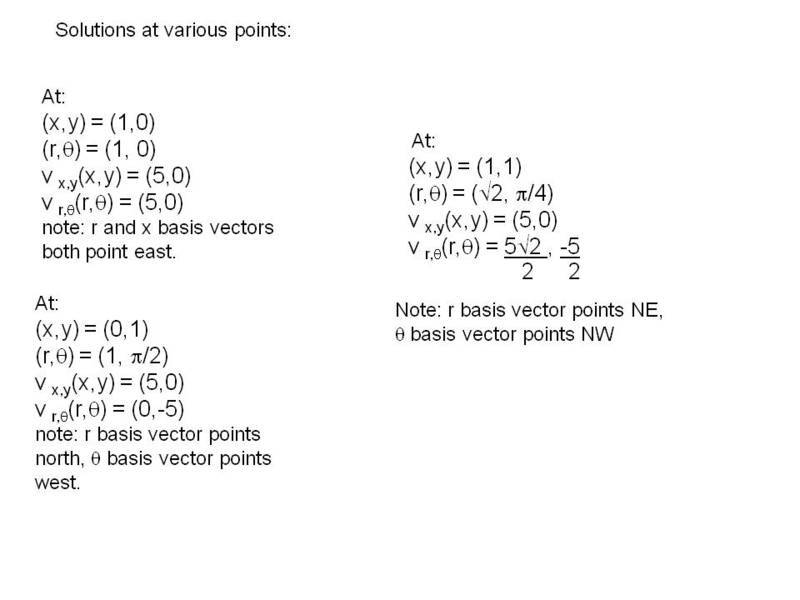

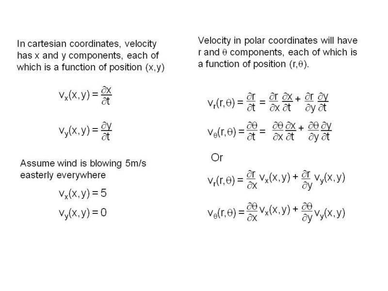

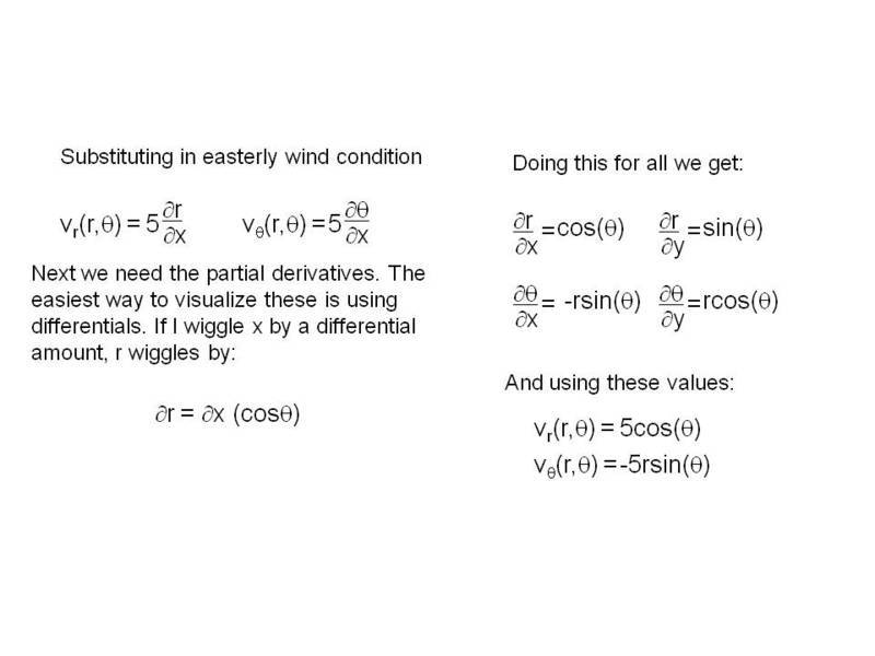

I have uploaded three images that I have created that show the cartesian to polar coordinate transformation for a contravariant vector. Specifically it shows step by step transformation for the easterly blowing wind example I discussed earlier. I am showing *all* of the steps, so it may be to verbose for many, but if anyone is having trouble digesting how this really works feel free to view.

I believe for your vector based at (1,1), the theta component of the vector is off. You have v_theta=-5*r*sin(theta)=-5*sqrt(2)*(1/sqrt(2))=-5 instead of -5sqrt(2)/2.
The polar basis vectors are not of unit length if one uses the regular coordinate basis. They are, however, at least orthogonal.
Most calculus books will use a normalized set of basis vectors in polar coordinates.

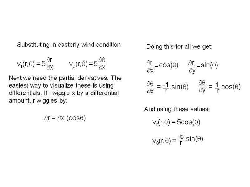

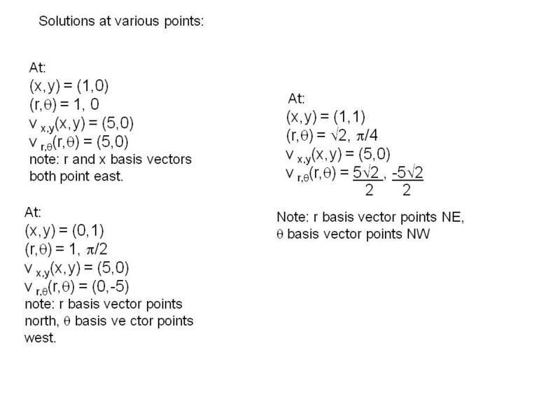

Thanks so much for checking this. I actually had the r upstairs instead of downstairs in the partial derivatives for d(theta)/dx, d(theta)/dy. I have corrected the second and third images accordingly.
